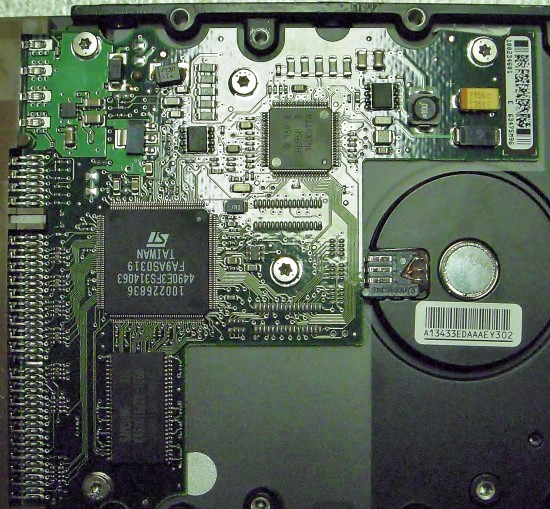

I have a
Seagate ST3120023A tha will not spin up
PN: 9w4001-301
Firmware 3.33
I could not find an exact match on the PCB for this drive but I do have
Seagate ST3120023A
PN: 9w4001-001
Firmware 3.30
I put this PCB on the bad drive and it spins up - but I can't get a PC to recognize the drive...
Can I fix the power interruption on the bad PCB?
Is there anything I can do to the working PCB to make it compatible with the drive?
There was a western digiatal in the same computer - same symptoms - I repaced the PCB on it with an exact match and everything worked like a charm....
Anyway - does anybody have any suggestions?
Does anybody know where I can find an exact PCB match for this drive?
Thanks for the help

scarm wrote:I put this PCB on the bad drive and it spins up - but I can't get a PC to recognize the drive...
as you said.. i don't think it PCB problem.

1-you must transfer the ROM on the bad PCB to the matched PCB, you have to post a photo of your original PCB to let us show you the correct IC to transfer
2-If the data is very important then you have to send it to a pro

Here is a photo of the bad pcb - thanks for the help on this
Pic of bad PCB
