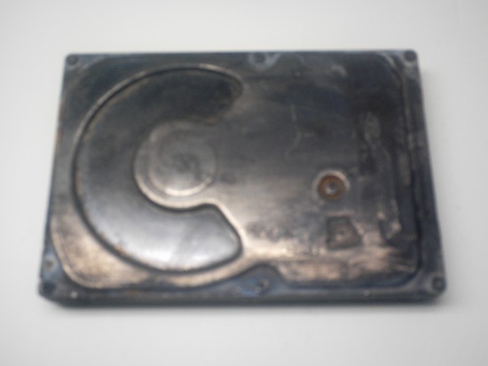

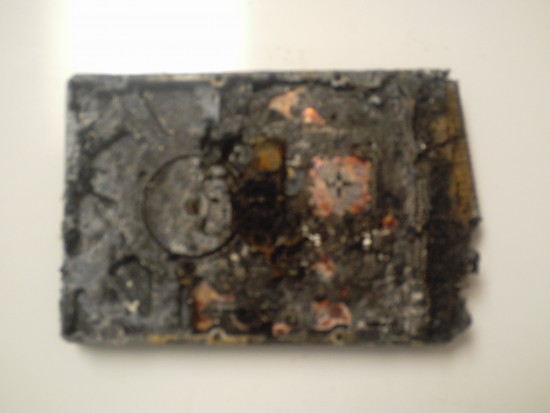

Hello everyone,
I have gotten a case with 6 systems that suffered fire damage this week.
2 have been recovered successfully as of current. 2 others are in recovery at this moment, 1 is about as old as the earth itself and of little value to the client. This leaves 1 important HD! The problem with this drive is that the PC was burned really bad, not just from the outside, but from the inside as well. Cleaning this one has been somewhat difficult, but the real fun part is that I have no idea what for a model the drive is. The PCB is totally melted. Guessing from the form factor the drive looks like a WD. Probably a 40GB or 80GB or possible even a 160GB. I have not gotten to the point where I can examine the platters yet, but I know for sure that I will need PCB and preamp donor. I am not sure how I can identify the drive for proper donor sourcing without DCM and Model number. :?
could the preamp code be helpful?

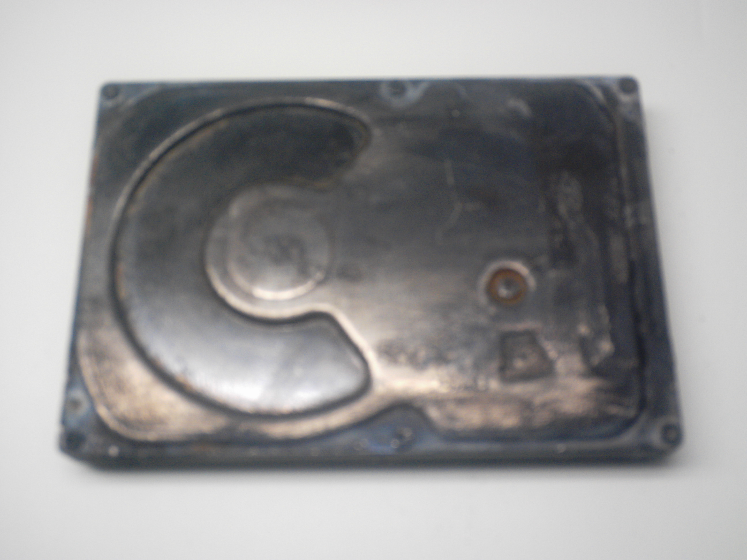

Re: Fire Damage
December 11th, 2009, 4:47
drccsc wrote:I want to see pictures too, even if just for fun! :D
For have fun:
http://adatmentes24.hu/hun/galeria_kepek/P1020457.JPG
http://adatmentes24.hu/hun/galeria_kepek/P1020462.JPG
Janos

Re: Fire Damage
December 11th, 2009, 15:34
I would almost guarantee from the pictures that it is a 80GB Diamond Max 9. Probably a 6Y080L0 and the code will probably be K,*,*,A.
Re: Fire Damage
December 11th, 2009, 16:40
Hexed wrote:I would almost guarantee from the pictures that it is a 80GB Diamond Max 9. Probably a 6Y080L0 and the code will probably be K,*,*,A.
This is my pictures, not quasimodo's pictures. :)
Anyway, you are right, the mdel match, i don't know about the asm code, because the top label was destroyed completely.
Janos

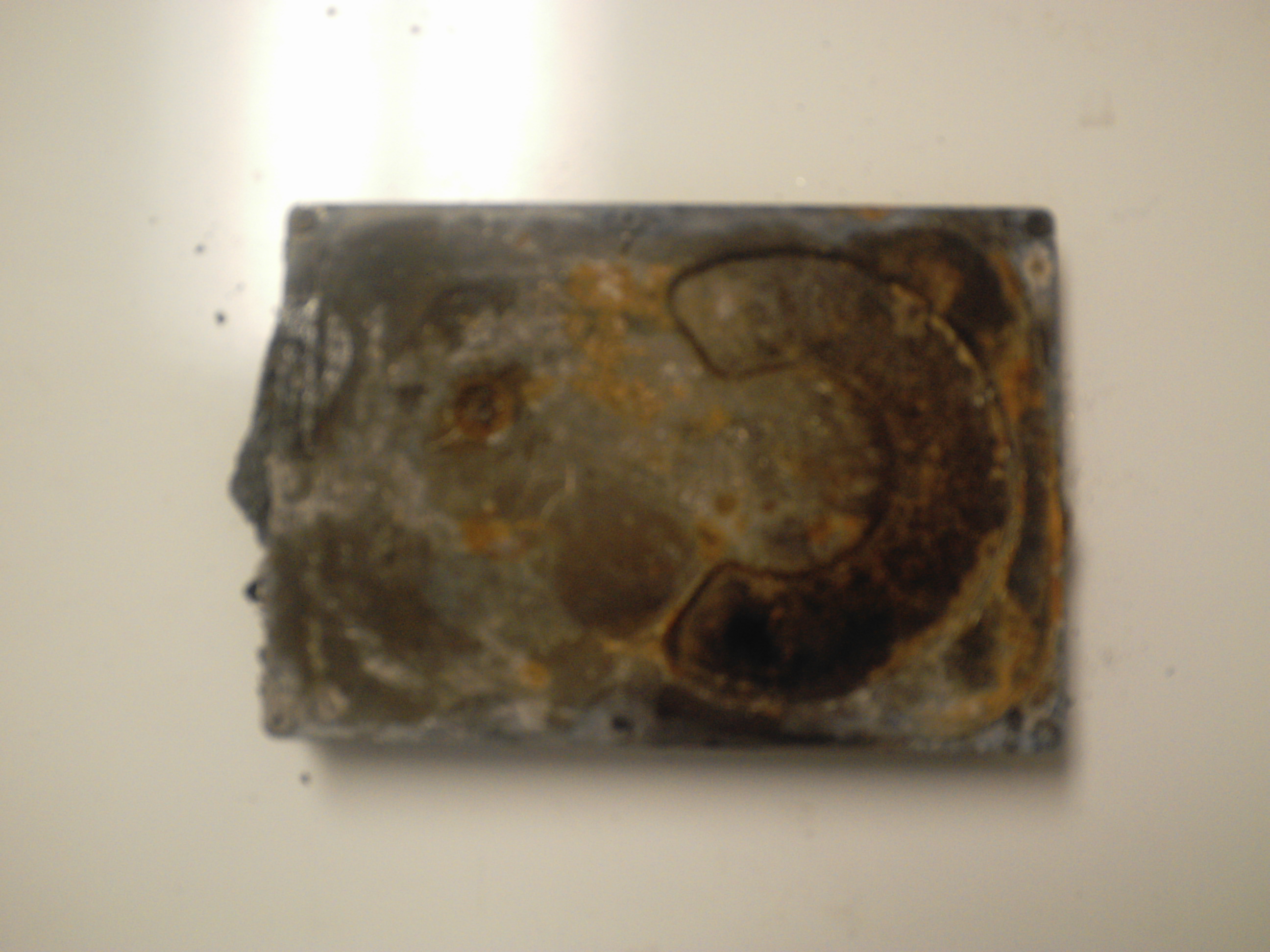

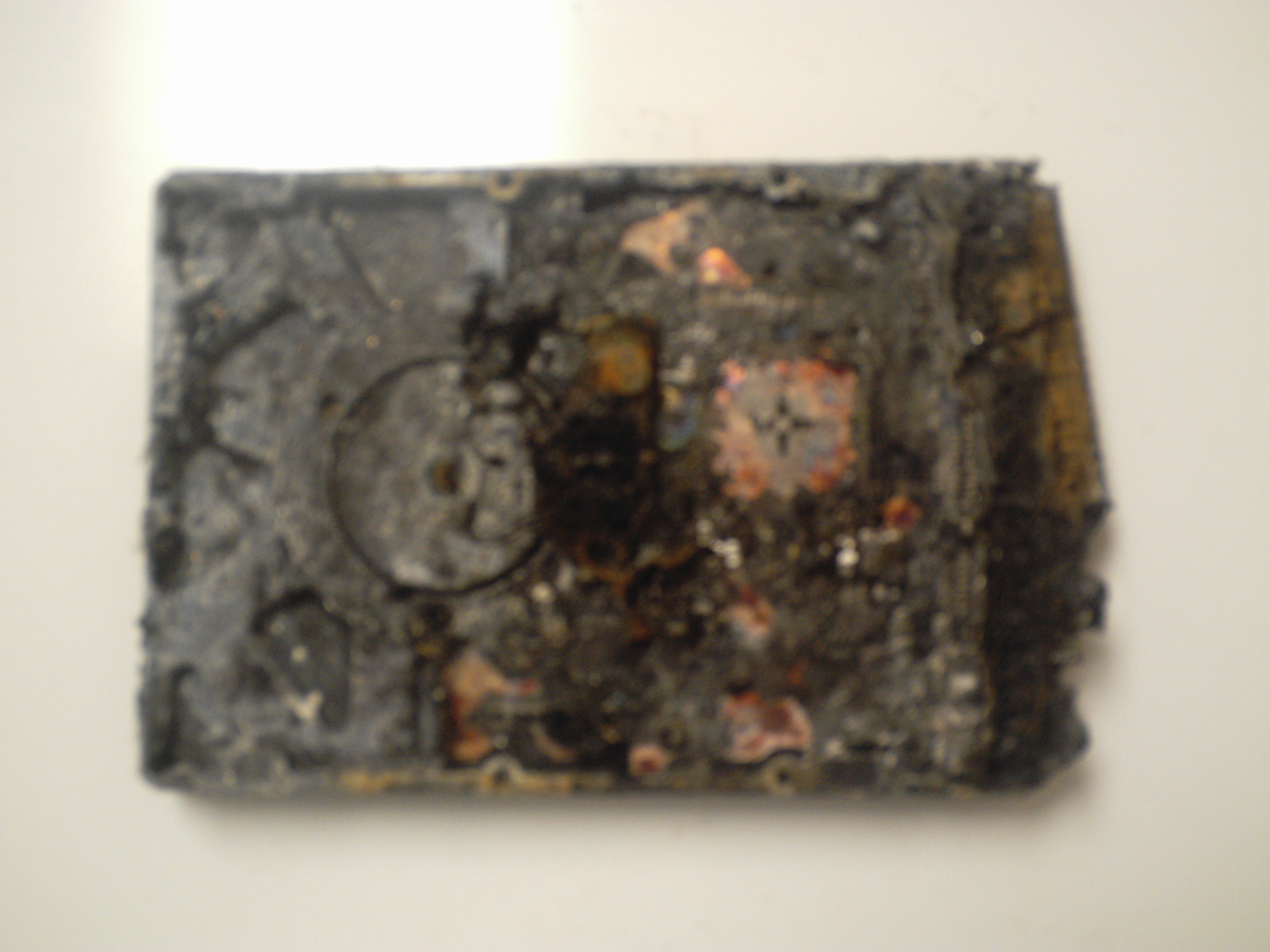

Re: Fire Damage
December 11th, 2009, 17:37
PCB Side
Re: Fire Damage
December 11th, 2009, 17:39
Top Side
Re: Fire Damage
December 11th, 2009, 17:40
MAXTOR ?
HITACHI !!!

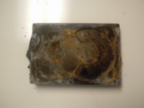

Re: Fire Damage
December 11th, 2009, 17:42

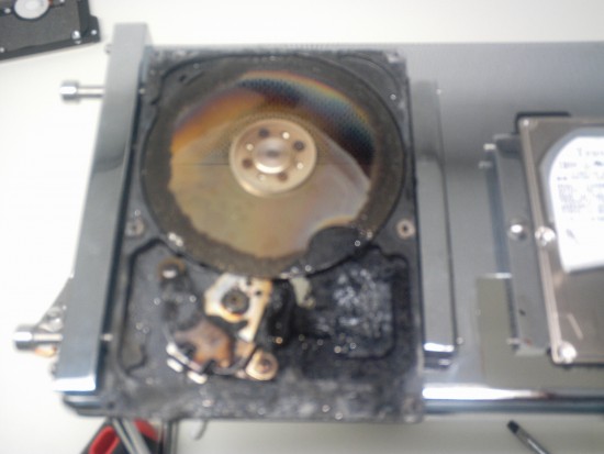

Cleaned drive
Re: Fire Damage
December 11th, 2009, 17:51
zebong wrote:MAXTOR ?
HITACHI !!!
I think i have something like that in stock will look tomorow morning to see it better.
I think Maxtor, thanks for checking, but it will not be necessary. As you will see with the next picture

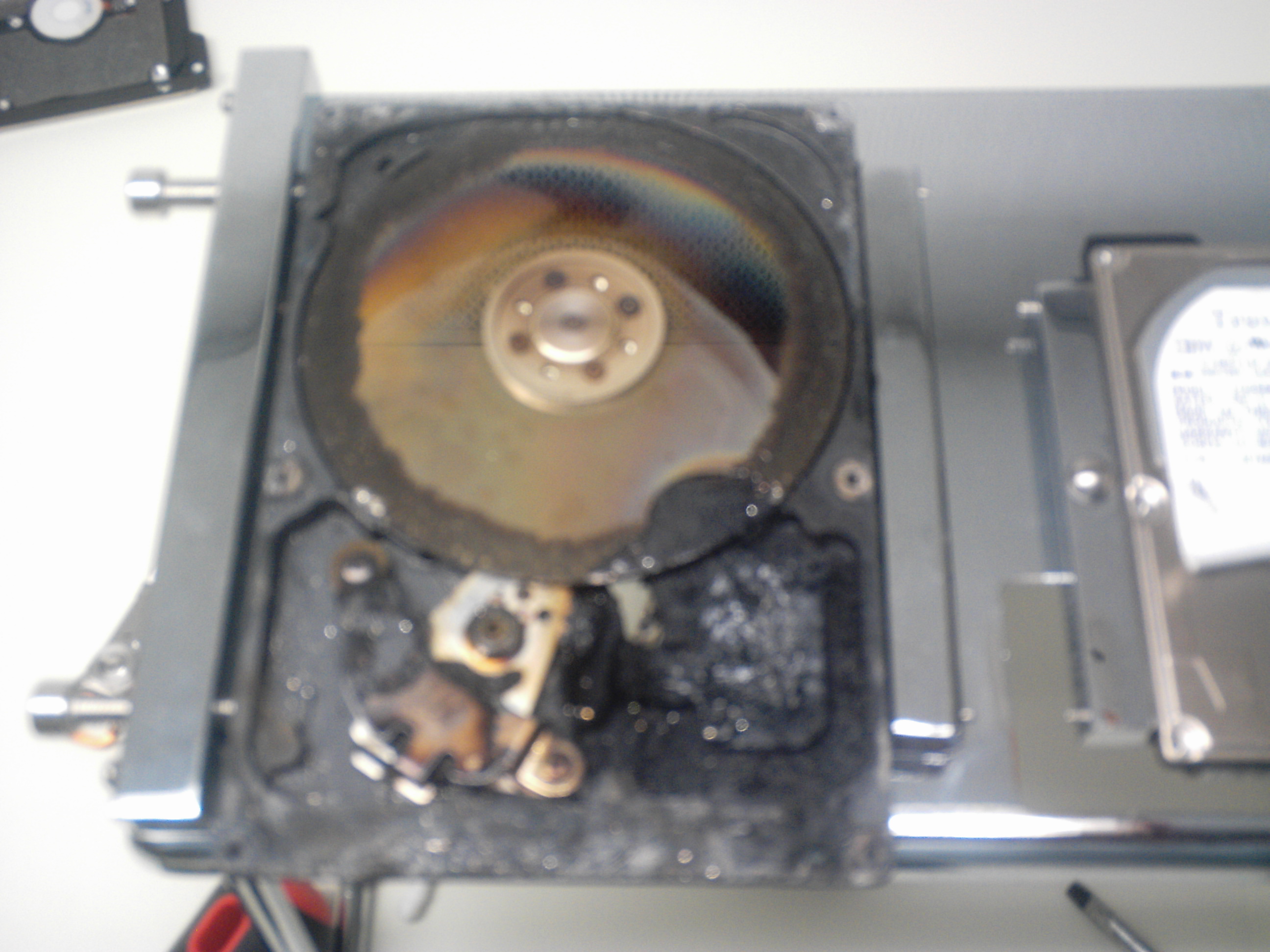

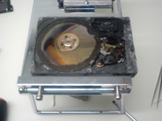

Re: Fire Damage
December 11th, 2009, 17:54

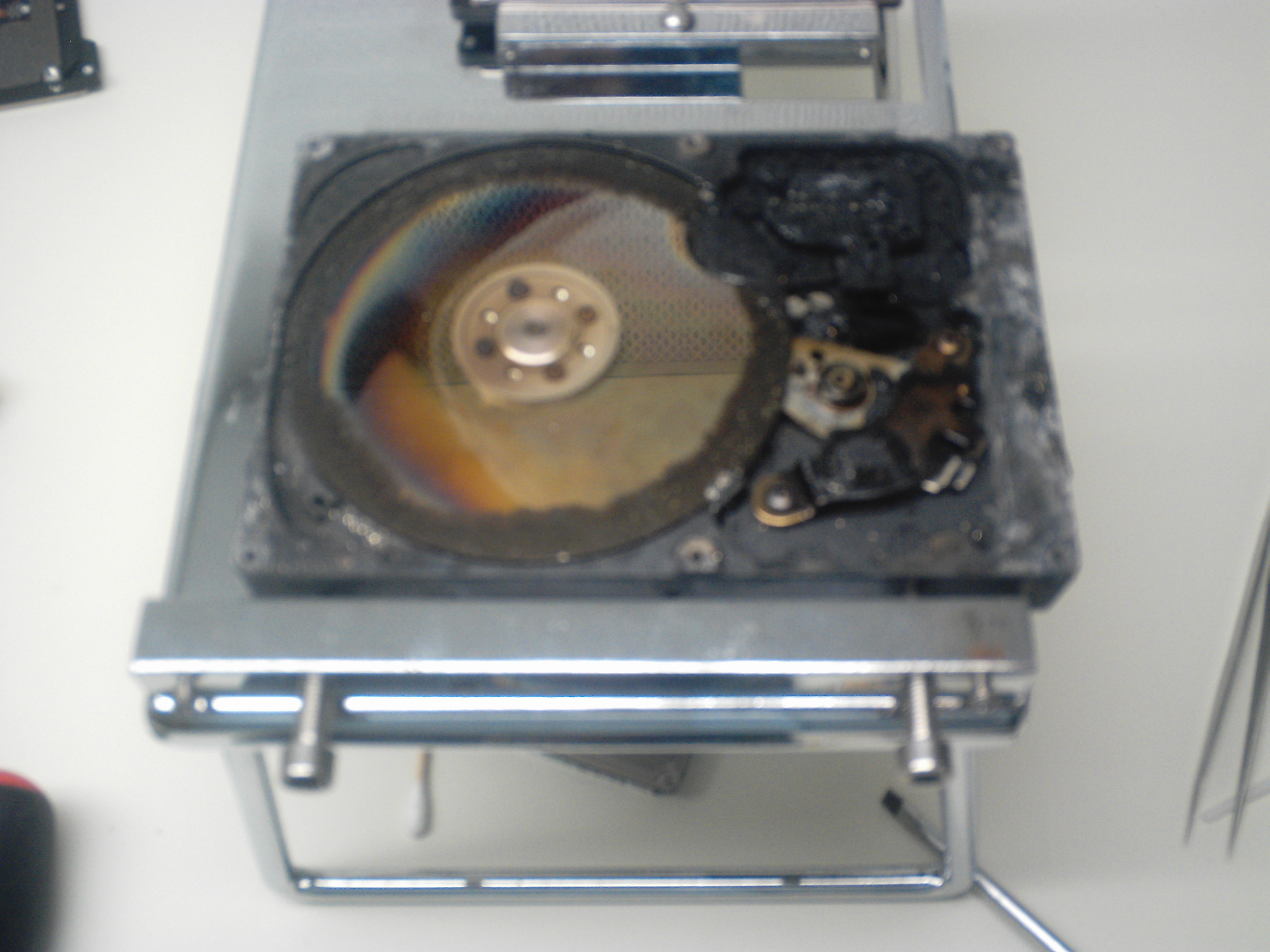

Now the Fun part!!!
This game is over!!!
Re: Fire Damage
December 11th, 2009, 17:58
:shock:
ohhhhhhhhhh
Yes i think is game over.
but will check anyway the disk that i have in stock just to see if we can match it.
But the Maxtor the heads are on the other side, don't know what other users have to say about this.
Re: Fire Damage
December 11th, 2009, 18:23
SP0411N. ;)
But yes, the disk surely have no magnetic information anymore...
:rip:
Janos
