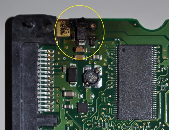

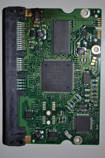

Many thanks. When I finally was able to remove the PCB (the chips and other components were on the other side of the board and were not visible at the outset) I came up with this. Obviously something is fried, as you can see at the top let of the image, which is circled in yellow further down. As a newbie, I have no idea what this is, or how it could be fixed. Any suggestions anyone?

Test it and the one below it for continuity.

i tested the diodes using a fluke meter set on diode test mode. This is what i got:
On the 'burnt' diode (top one) i get:
0.001 with a continous beep one way
0.001 with a continous beep the other way
On the lower diode (unburnt) i get:
0.454 with a single beep one way
1.392 with no beep the other way
Does this help?
Re: Lookng for HD data recovery
January 24th, 2010, 11:55
AT YOUR RISK...
Remove the top TVS (ideally desolder, but if not you can carefully snip if off) and fire the drive up, if it doesn't spin up right away then turn it off and seek pro advice.
Bear in mind that if you remove the TVS, the drive is unprotected so make sure your PSU is up to scratch.
January 24th, 2010, 14:29
Sorry guys, unfortunately I removed the burnt diode but the drive won't start up. What are my options? Can i get the board replaced or have the drive taken in to a specialist? Who can i take it to, considering that where I live (Gibraltar) there are no such people / firms?
