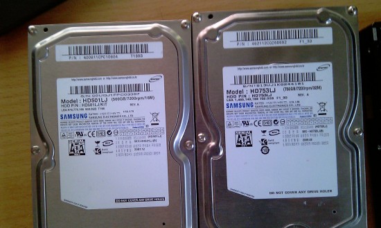

So I was googling for samsung PCB swap, and I saw a post from another somethingawful member who had been referred here.
I been stressing over 4 discs since I moved recently. I took extra special care of them when I packed them for the move;
foam wrap, big-air-bubble-wrap and a quality cardboard box.
Then I packed the box out so it was a nice and tight fit.
None are registering since the move;
I've tried them on 2 diff mobo's, 3 diff PSUs, and diff cables too.
I was looking to retire them soon, since they were long in the tooth.
But obviously, I hadn't gotten around to backing them up and hence my problem.
Samsung, 400, 500, 750 & 750 have all stopped working.
I had a PSU problem before the move, so the discs had been idle since then.
I'm not 100% sure, but I think this may have been the cause.

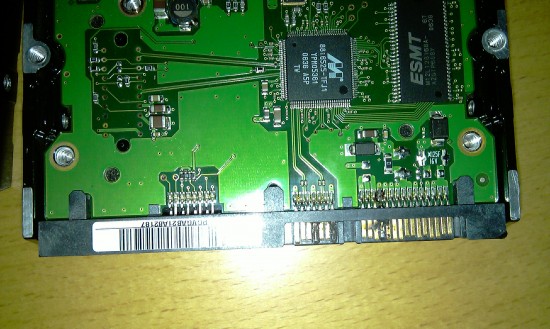

The 400 has a burn on it. (pic attached below)
The other three look fine in my eyes.
The 500 and 2 x750 are still under Samsung warranty until the middle of next year which gives me time to breathe.
But I want the data off them before I RMA.
S13UJ1KQ244xxx HD753LJ INW 2011-06 100 In warranty
S13UJ1KQ244yyy HD753LJ INW 2011-06 100 In warranty
S0UQJ1FPC03zzz HD501LJ INW 2011-03 100 In warranty
My question is this:
the 750's are still quite widely available, so I'm hoping a straightforward PCB swap will do the trick.
the 500 is not available where I have been looking.
Has anyone had any success using a spinpoint F3 pcb on a spinpoint F1?
Is that even the right course of action?
tia, grateful for any help.
500 & 750
400 with burn

BlackSt and N.C. are right , you can not simple change the PCB.
you should look for pro help.

Thanks for the replies, it's appreciated.
Damn!
I already RMA'd the PSU that did the damage, and I can live w/o recovering the data on the 400.
I should have been more clear though; only the 400 has the burn on it, the 500 & 2 x 750's "look" okay.
I have already ordered a 750 of the same type as the ones I have.
I'm guessing it will not cause further issues to try it right?
I figured that the 500 would be the issue since it's the oldest and not generally available.
I replied in this thread for a similar spec 500.
When you say repair the PCB's, have you any idea what is the matter with them?
When you say you can help, can I send on the PCB's to you for repair?
Apologies for the quality of the pics.

For PCB repair on Trident & co. in case of MCU failure the drive is also needed ... too many variables (that's why simple PCB swap doesn't work...)

March 31st, 2010, 6:43
Do you have a multimeter?
If so, then measure the resistances of the TVS diodes and zero ohm links near the power connector.
If a diode is shorted, then remove it. If a zero ohm link is open, then replace it with a 2A picofuse or a piece of wire.
If you need more help, feel free to ask. One of us will help you.
