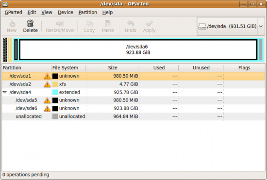

Does this look normal for a buffalo link station live? The drive imaged ok with loss of readiness about 50 times for 1tb. It seems that the file system is xfs but corrupted.

What does UFS Explorer see?

fill in the missing sectors by cloning using ignore ecc.

pcimage wrote:What does UFS Explorer see?
Unfortunately all software tools including ufs explorer see nothing...

HDD Spaz wrote:fill in the missing sectors by cloning using ignore ecc.
DE read all sectors including sectors that had loss of readiness. Its a WD10EACS - 22D6B0.
