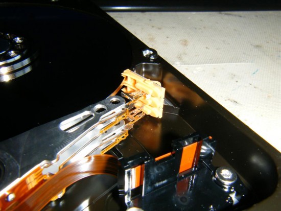

Hello everybody,
A friend of mine gave me a WD5000AAVS-00G9B1 making a click-click noise (but spinning normally) once powered up. She dropped it (was an external) while actually accessing it! :S
As I didnt manage to detect it even as hardware, I removed the cover to see that the 2 out of 4 heads were dead. One was actually broken and bent towards its pair head and then stuck together in the parking guide.
I can still find a new WD5000AAVS in the shops but I dont know the complete model number. Can I swap the whole head unit or are some models not compatible?

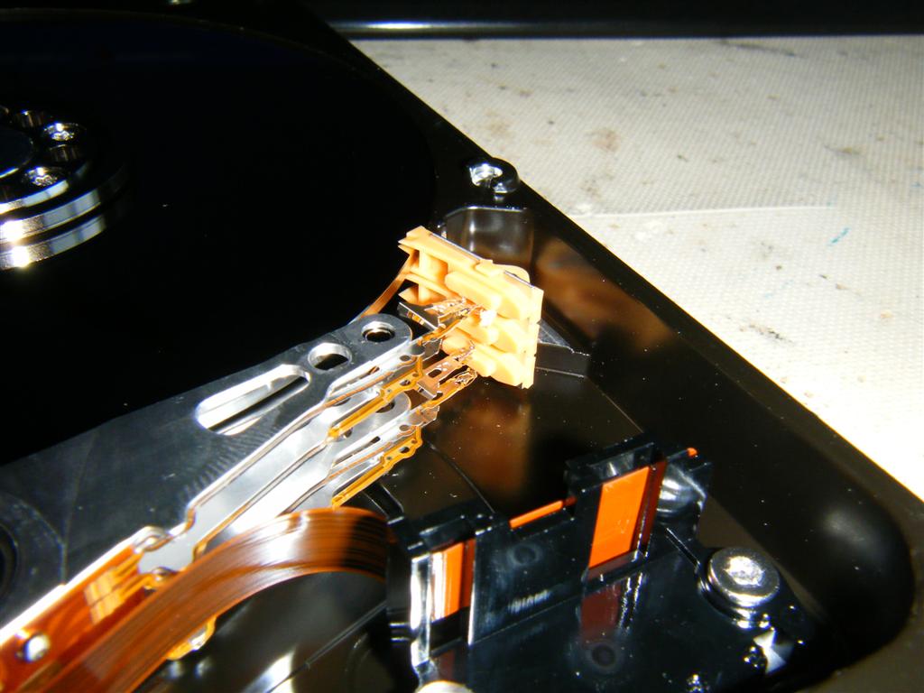

June 13th, 2010, 8:41
Here is a photo of the broken head...
Re: WD5000AAVS head replacement
June 13th, 2010, 9:55
I can see some dust on the platters and 4 crashed heads. :?
More attempts will make things worse.
I expecting $$$$ for recovery at this point.
Anyway, good luck.
June 13th, 2010, 12:13
And fingerprints all over the place...
June 13th, 2010, 17:10
DR charge more since you open it. it become worse :?
June 14th, 2010, 14:27
This is now a VERY expensive if not impossible recovery.
