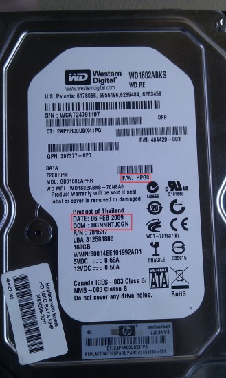

I have a Western Digital WD1602ABKS SATA drive that has failed. The bios sees the drive after sometime and Windows sees the drive when added as a salve drive as unreadable.
The drive recovery company that I'm using tells me that the PCB is at fault and for them to recover the data they need a donor drive for the PCB but this needs to be an exact like for like match e.g. firmware, DCM etc.
Even though the drive recovery company are a Western Digital approved recovery partner they are unable to get the spare parts, due to the drive coming from an HP server?????
I have attached a picture of the failed SATA drive, can anyone help me out with advice or spares PLEASE

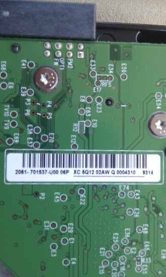

Need a photo of the PCB.

richg wrote:The drive recovery company that I'm using tells me that the PCB is at fault and for them to recover the data they need a donor drive for the PCB but this needs to be an exact like for like match e.g. firmware, DCM etc.
This is very incorrect. Either they are spouting off some jargon for you or they don't know what they are doing.

June 27th, 2010, 18:39
richg wrote:So the data can be recovered without an exact replacement PCB?
The relevant information on the PCB can be retrieved from it and programmed to a new one if it is in a working state... which it sounds like it is, since you said it is eventually recognized by the BIOS.

Re: URGENT: Western Digital WD1602ABKS Failed PCB
June 28th, 2010, 3:27
Doesn't sound like PCB to me either, probably a FW issue since it ID's after a while.
Even if it were bad, there should be no need for an exact match, since a new one from same family drive can be programmed with the relevent ROM data.
Disklabs as far as I know are pretty a straightforward bunch and so unlikely IMHO they're actually lying to you (unlike certain other so-called DR outfits) , but what could be plausible is that they might want a close matching drive to perform a smart hot-swap.

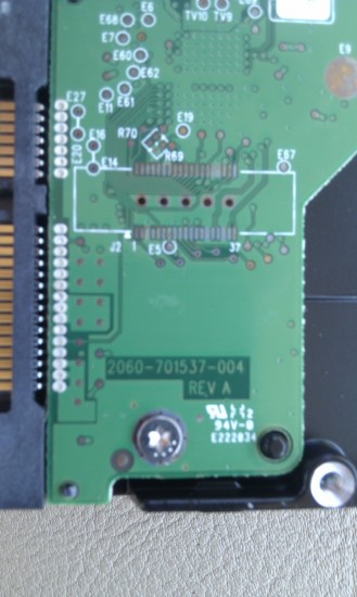

June 28th, 2010, 6:08
Pictures of PCB

June 28th, 2010, 6:28
The problem not the PCB as you said that the bios sees the drive after sometime and Windows sees the drive when added as a salve drive as unreadable.
Then it might be SA damage or the problem elsewhere but not the PCB anyway. And I agree with Mr.Sean maybe they want a close matching drive to perform a smart hot-swap to fix the SA.
June 28th, 2010, 6:31
This HDD is from the Tornado family. PCB is not difficult to source. ID is different simply because it has been rebranded as it is from HP Server, this happens on many HP based disks including SCSI and new Seagates, but does NOT change the family type.
If it is PCB, parts are easily accessible so I am not sure why you were told parts could not be found. DCM is nt so important here also.
Maybe Sean is right, and parts for hotswap were required. I guess in this case parts may be slightly more difficult to source.
