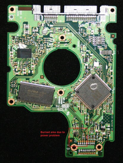

Greetings ,
I am new here, and I have never done any PCB swapping before. So please be easy on me :wink:
I have a burned PCB on my HITACHI drive because of wrong voltage, I went and bought a matching PCB (I tried to match everything).
Now, what is the next step? just replace the PCB and go? or I must do other stuff?
I appreciate if someone could tell me if there is any online step by step guide.
many thinks

You have to change Rom chip on the drive , use the search function on this forum you can find detailed help .

Re: PCB Swapping for Hitachi Travelstar 2.5 60GB SATA
July 6th, 2010, 15:25
according to the guy who sold me the PCB, it should work with simply switching the PCB , can someone confirm this?
July 6th, 2010, 16:18
He's either lying, stupid or thinks you are gonna get lucky in a 10000/1 chance of a new PCB working without NVRAM transfer.
That or you have misunderstood him.
I have only ever seen it on one occasion where one PCB will work on two drives of this type without NVRAM transfer, and I've seen lots!!!
July 6th, 2010, 17:36
Whilst the PCB is certainly a compatible donor you will need to get that NV-RAM content over to it.
You may be able to adapt the resident NV-Ram on the part to work with the failed drive using specialist data recovery equipment also. Otherwise a physical swap will be required, this can also be tricky without the proper equipment.
Assess your own ability, if you are up to the component swap then determine which chip is the NV-RAM (you might get help here) and go for it. If the data is critical and you cannot run the risk of losing it (or if it belongs to somebody else), YOU MUST start trying to find a pro. This might just be he place to find that person.
July 7th, 2010, 2:48
Hameed wrote:according to the guy who sold me the PCB, it should work with simply switching the PCB.
If you upload a detailed photo of your PCB, one of us will be able to identify the components for you.
July 8th, 2010, 6:32
Thank you guys,
you helped me a lot, just to clear all doubts about which rom I should swap, am attaching a picture of the original PCB showing the burned area. It would be great if you could show me the exact part.
Best wishes
Picture of my original burned PCB
July 8th, 2010, 7:16
The NVRAM chip is U6.
Transfer this over to the PCB and assuming it's "only" a PCB problem and the NVRAM is OK then it should work.
July 8th, 2010, 9:16
Becareful.
Only one mistake and you will ruin DIY chances and will make the recovery cost jump to $$$$.
Good luck
July 8th, 2010, 10:16
I think I should take my PCB to a pro to swap the NVRAM
July 8th, 2010, 16:35
Hameed wrote:I think I should take my PCB to a pro to swap the NVRAM
Or at least someone with expert soldering equipment and skills.
