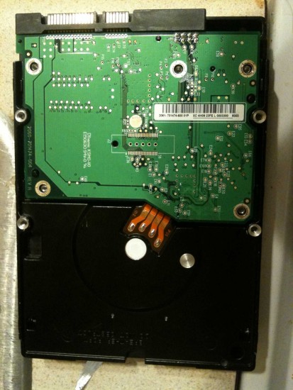

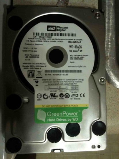

Western Digital 1 TB WD10EACS (WD Caviar GP)
MOL: WD10EACS-00ZJB0
DATE: 29 SEP 2008 R
DCM: HBRCHV2AB
PCB LABEL: 2061-701474-600 01P XC 4H09 23FE L 0003300 8303
The smooth chip got burnt when i plugged it into a wrong adapter. Worked fine prior to this.
Any ideas where I can find one? Also will I need to transfer ROM data and any tutorials around here for that
Photos of front and back to the hard drives are attached to the post!

The pcb is : 2060-701474-004 and does NOT have a U12 chip.
Does anyone know how would I be transplant the ROM info if I get a new pcb?

The adaptive info that you need to transplant lives on the main controller chip I would imagine. Pro tools are needed to transfer. I seem to remember ppl recommending a place that supplies the pcb and swaps the rom for you. Onepcbsolution.com or somethinl like that. Never used them myself.

No, pro tools meaning software tools to move the adaptive info from the one PCB to the other. There's no simple U12 swap here, the info that needs to be swapped across (that's otherwise stored on the 8-legged U12 chip) is stored on the main controller chip. Not a DIY job.

If you have experience with this kind of soldering work, then you should be able to do it. However, be aware that the SMOOTH chip controls the DC-DC converters that supply the Vcore and Vio voltages for the MCU. I have seen at least one case where the the MCU's core was damaged. IMO it would be easier to replace the SMOOTH chip and repair the DC-DC converters, if necessary.

UNFORTUNATELY the chips are not "easily" available, and the unique easy way for "average joe" is to get from other working PCB but again you have to SAFELY move the chips.... And still the state of preamp is unknown. AND you don't have schematics . AND ...
About "So again why can't a person desolder and move the mcu over to the donor pcb?" the answer is simple : 40 years ago the man went to the moon, but you can't call ACME and make a rocket unless you are Wile E. Coyote 8).
So, unless you have the proper equipment , it is not easy (less than less if you have to deal with BGA chips, despite all youtube videos and tutorials) AND it is risky. At present, assuming there is no internal problems, the whole thing is simple to fix even if the entire PCB is fried completely - of course by PRO.
