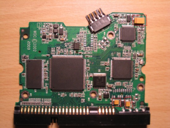

Here is a picture of my PCB, I don't see any damage. If my HDD still has no power (disc doesn't spin), is the PCB still the culprit?
Thank you.
PCB
Re: WD800BB No power - New PCB? :(
January 18th, 2011, 22:17
The motor connector has a blister which suggests overheating. Examine the underside of the board for any scorch marks in that area. Other than that, there appears to be no visible damage.
I'm still betting on the PCB being the culprit. When you receive a replacement, try it first without a ROM swap. The drive should spin, but it probably won't be detected by BIOS.

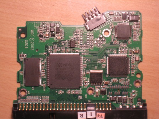

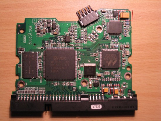

I have received both PCB's. The HDD now has power, but makes a clicking noise and freezes on the bios screen stating "Detecting IDE Drives". I've tried both PCB's that I have received and both have the same result - clicking noise. I believe I need to transfer the U12 ROM chip, but which PCB should I transfer it to?
I will list the details of all PCB's below - Main Controller Chip:
*If you look at the pictures of the two new PCB's below, you'll notice that they have slight physical differences when compared to the old PCB(pictured above). Is this a concern? I have circled the differences for your convenience.
January 22nd, 2011, 1:24
Both PCBs should work. Otherwise your drive has 1 defective head or damaged Preamp.
You'll need a pro intervention to retrieve your data.
Good luck
