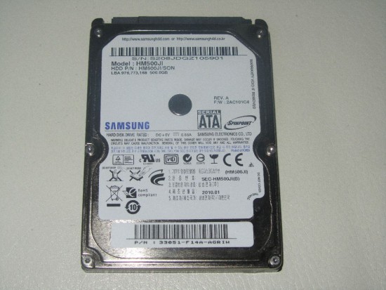

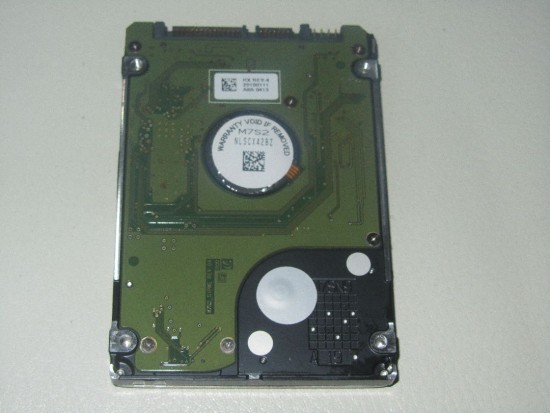

Yesterday the hard drive on my laptop died. It is a Samsung HM500JI drive. Here's what happened:
The last two weeks or so, my computer has been getting worse and worse. First I started getting BSODs, most of them saying something like "kernel data inpage error". I would get them maybe once or twice every day. Then about a week ago it got worse. The first thing I noticed was that whenever I hit the windows key and did a search for a program my system would stop responding until I cancelled the search by hitting escape. I just figured that something was wrong with windows, so I stopped using the search knowing that I had planned a reinstall of windows anyway. Then a few days later, it started to get REALLY bad. After typing my password it could take 10 minutes for windows to be ready. Opening a program could take several minutes, however, once a program did finish opening it would mostly run smoothly.
After about two days of this my computer shut down and it wouldn't start up again because it couldn't find a hard drive. I went out to get a new one, and now everything is running again, BUT I would like to make an attempt at recovering the data. It is not critical since most of the important data can be recreated (although I would take some time :cry: ). So I don't think I am interested in having this done professionally.
So my questions:
1. What is most likely to be wrong with it?
2. What can I do to try to recover the data?
Pictures of the drive included below

1) It's died. Most probably internal problem (seen a lot on HM160Hx don't know why). Was it jarred / experienced shock ?
2) Nothing at your reach as the drive is probably not recognised at all (see if it clicks (even a faint clicking) at startup , if vibrates excessively in comparison to an identical drive, if starts then spin down, etc.) and pro gear is necessary for complete diagnose and eventually perform intervention.
Before you ask : replacing the PCB is a waste of money and time. Accept the loss as you said there's nothing important on it. Otherwise take it apart for fun and destroy it, at least you see how it is made.

tma82 wrote:After about two days of this my computer shut down and it wouldn't start up again because it couldn't find a hard drive.
Can you confirm whether the make/model of your drive is shown in the BIOS setup screen of the PC?
If the drive make/model is not shown in the BIOS setup (i.e. the drive is not responding to the BIOS correctly for even an ATA Identify Device command), then as BlackST says, your ability for DIY is likely to be zero.
However if the drive make/model is shown in the BIOS setup, and the error message about not being able to find a hard drive which you mentioned, is really one about not being able to boot from a hard drive, then you might be able to something - search the forum for posts about "cloning", and you'll see some suggested programs. Although they won't be as capable as some of the professional equipment, if you have decided against pro help, then that would be something that you could persue, at your own risk (especially since the drive is clearly deteriorating).

The fact it is not shown at POST in BIOS then comes up after a while "that way" makes me think about two or three things, but it's not DIY- fixable in any case if my hypotesis is correct.
It is strange that a recent drive (2010 manufactured so I assume it has about 1 year or less) developed "by itself" such a problem, unless it is a case of always possible infant mortality - however Samsung drives are really well made.
If you were here I could make a test and eventually (loosing everything on it) fix it like brand new for a small small small fee (NO RECOVERY, if you want to have data recovered it has a VERY VERY VERY different price).
