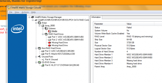

After installing a new Revodrive, successfully into Windows 7 Pro, my Intel Matrix Storage console is reporting that two of my four Raid 10 drives are "missing hard drive". But the two drives are listed under the "Non-raid drives" section. I cannot figure out why they have been removed, or how to restore the volume.
I tried removing the revodrive and booting without it, but during POST, the Intel controller is reporting the same thing. There are no options to restore, reinitialize, etc. Reinstalling the revo drive changes nothing.
Thinking that all my life's critical data was safe on a Raid10, i have over 2 TB of data there that I really would like to get back. I haven't done anything yet to the volume that would add to it, hoping there is some way of rebuilding the volume somehow. The data is all there, but for what ever reason the Intel controller doesn't think the two drives are part of the raid.

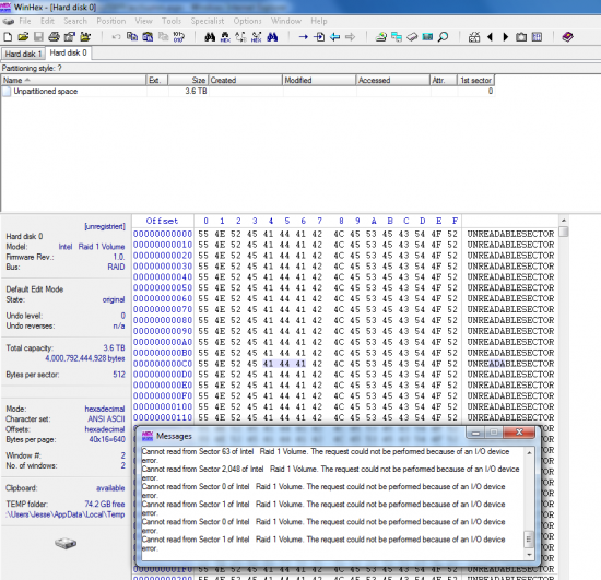

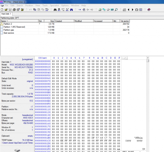

Using Winhex, I can open the two drives that appear to have ben dropped from the volume. I believe they are the same half of each side of the volume, which is bad news.
Here is the worse part. The part of the raid that is still "intact" seems to have been corrupted. When I use Winhex (or any other program) to access it, the program freezes for a long time while trying to read from it. Eventually, it will start reporting back that there are I/O errors and corrupted sectors along the side I think a data recovery service is going to be my only bet here...

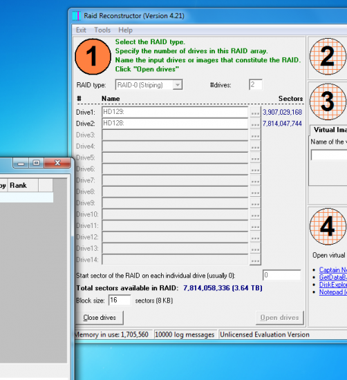

I had tried all sorts of combinations with the BIOS. IDE, AHCI, Raid, with the revo in, took it out, some drives in, some out. No change. My first run of Raid Reconstructor was "Not significant" or something, so I bumped up the sector scan size to 500,000. The log also gets really full really fast of messages "unable to read sector, entering recovery mode, successful". So, it seems that something has happened to mess with the integrity of the data on part of the volume. I'll see what it says after a scan at 500k, and go from there. My question is this, now. The raid controller still thinks there is a raid 10 hanging out somewhere. This is causing the computer, and RR, to see one of the physical drives as a 4tb drive, or something like that. I'll post a SS. The question is, would it help or hurt to "break" the raid at this point? I mean, the data will still be there, in some form, I think. Does it give me any advantages or disadvantages? I know I can't go back once I do that, so I am reluctant.
Re: Revodrive + Asus Sabertooth X58 + Intel Raid 10
March 10th, 2011, 14:38
Bluntly, raid reconstructor sucks.
If you image your drives then you at least know that you have a copy of everything before you start messing with it. At this point you don't even know if some of the drives are not working correctly, or have bad sectors, or whatever (I'm guessing no, but the fact that you are trying to access them through the raid controller instead of individually is clearly causing issues)
You said the two drives that have dropped out appear to be mirrors of each other? Then you just need one drive from the other mirror set, and some software that will emulate the raid setup and let you pull off the data (or image, or whatever)

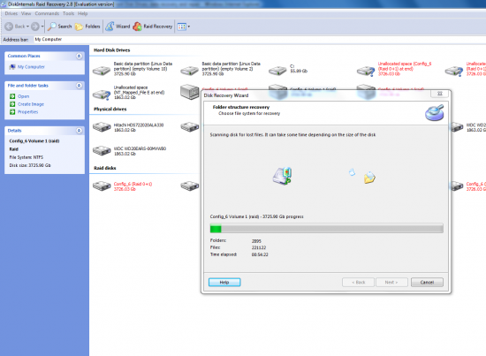

So, I think I'm on the right track...
Installed my old PS3 60gb sata drive that I had laying around after removing the revo. I reverted the Intel controller to IDE mode, and did a fresh install of Win7. After hours of install and updates (stupid hdd is sooooo slow), I installed the trial of RaidLabs Raid Recovery. Put in the settings and within a few minutes it was showing me the recoverable files that were available. It seems like most, if not all, of them should be viable. Looks like it will be the best $$$ I will ever spend on software...
I have to say thanks to you all for your assistance, and to hhansard on the ocz forums for pointing me in the right direction!!!
