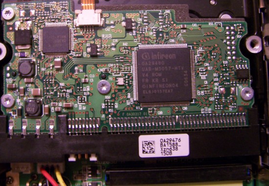

Hi there,
I found this forum and it looks like a good place to start. I have someone whos external hard drive stopped working. They were quoted $2000 from someone and they don't have that. But it has their 2 year olds baby pictures on it they didn't make copies of so they want to recover the data off it.
Someone had them take the actual drive out of the external case and try it in their computer. They said it would power on before they did this and they may have touched the circuit board a little too but now it doesn't power on anymore at all. Now I have it and am wondering what can possibly be done to make it spin up and read the data off. It doesn't spin up in it's case, or if I attach it directly to a power supply in a computer.
I can't see if there are any burnt chips or anything on the drives PCB, either on the front or back of it and nothing smells like its burnt.
I only have the top of the external case and all it has is a Lacie logo and: Design by F.A. Porsche
There is also a sticker on the top side of the back panel: 1046611011364CR 3U2

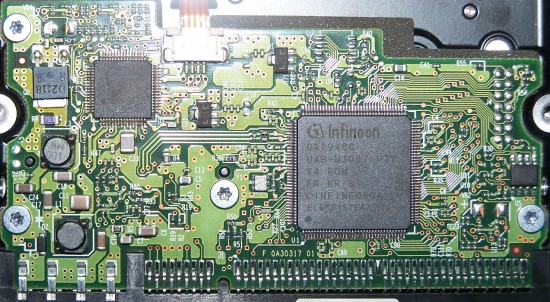

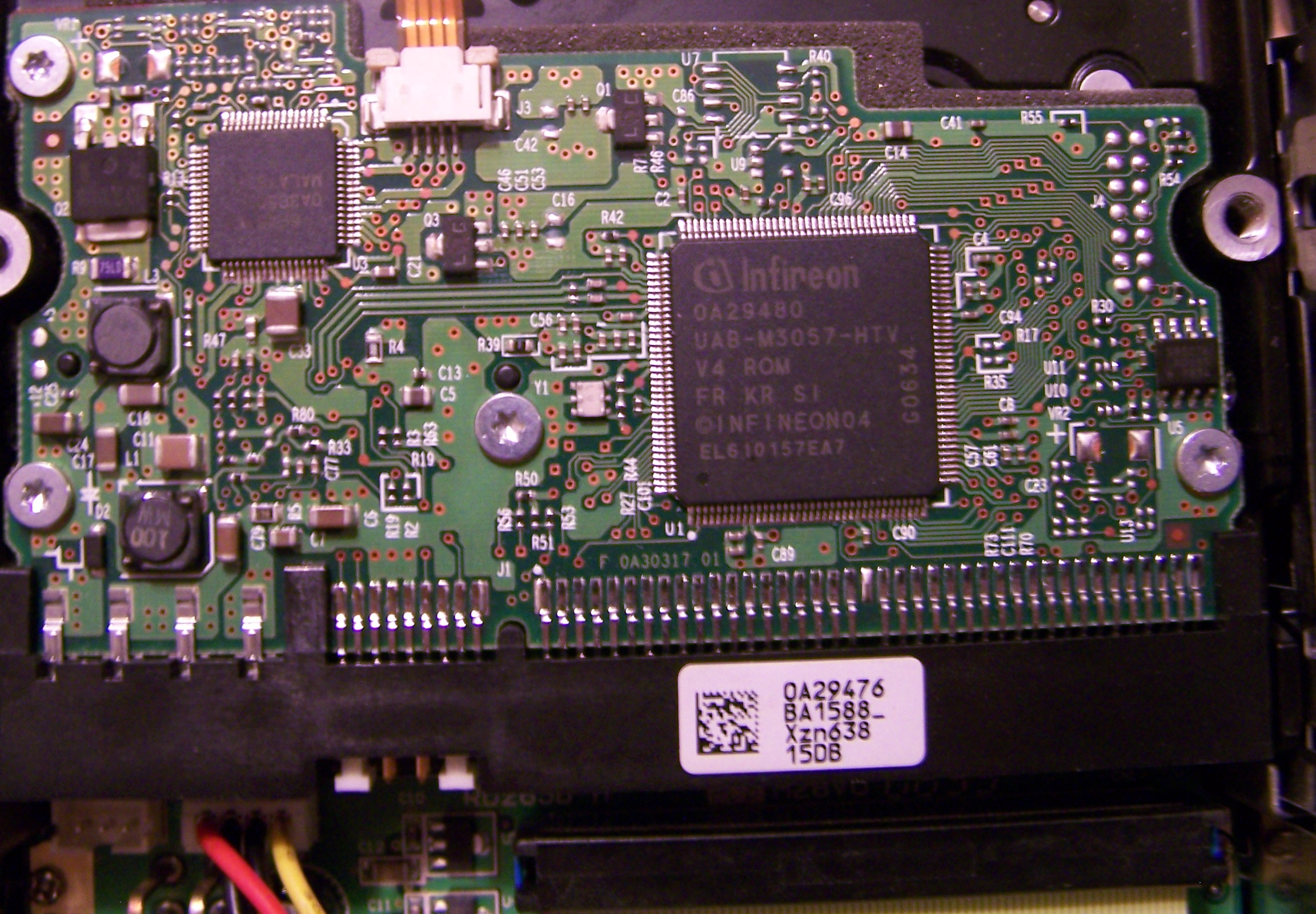

If you can upload a detailed photo, and if you have a digital multimeter, I can help you with some measurements.

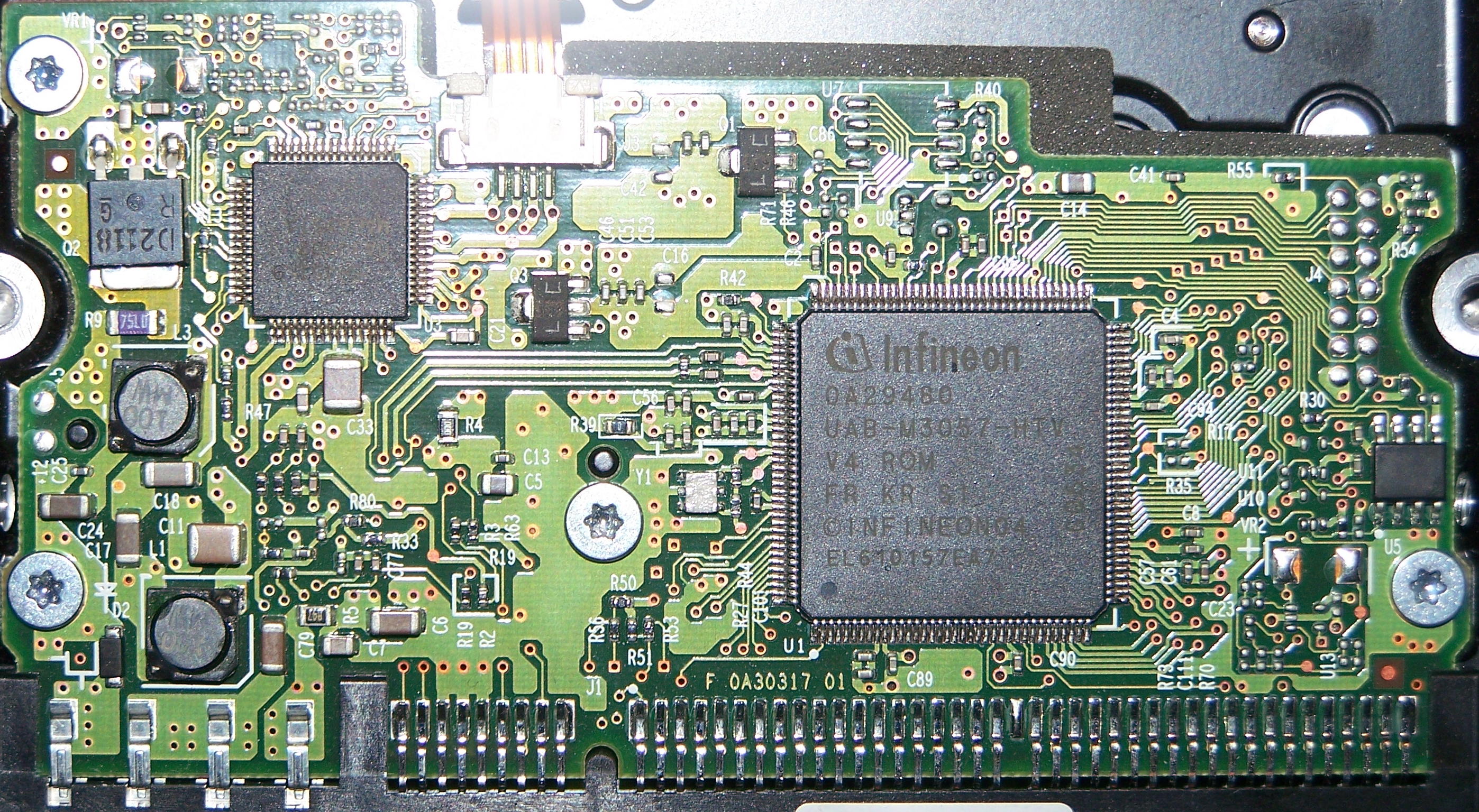

I took some pictures but they might not be the best quality possible with this camera.
I got someone to bring a multimeter as well.
I will search for the info and test it, thanks!

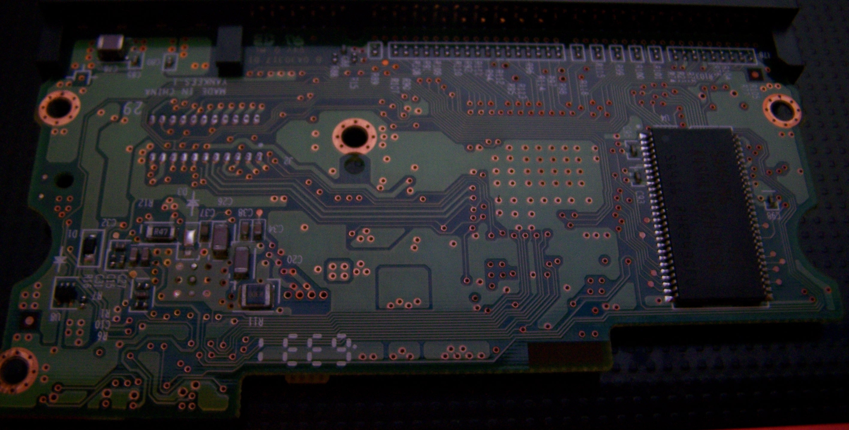

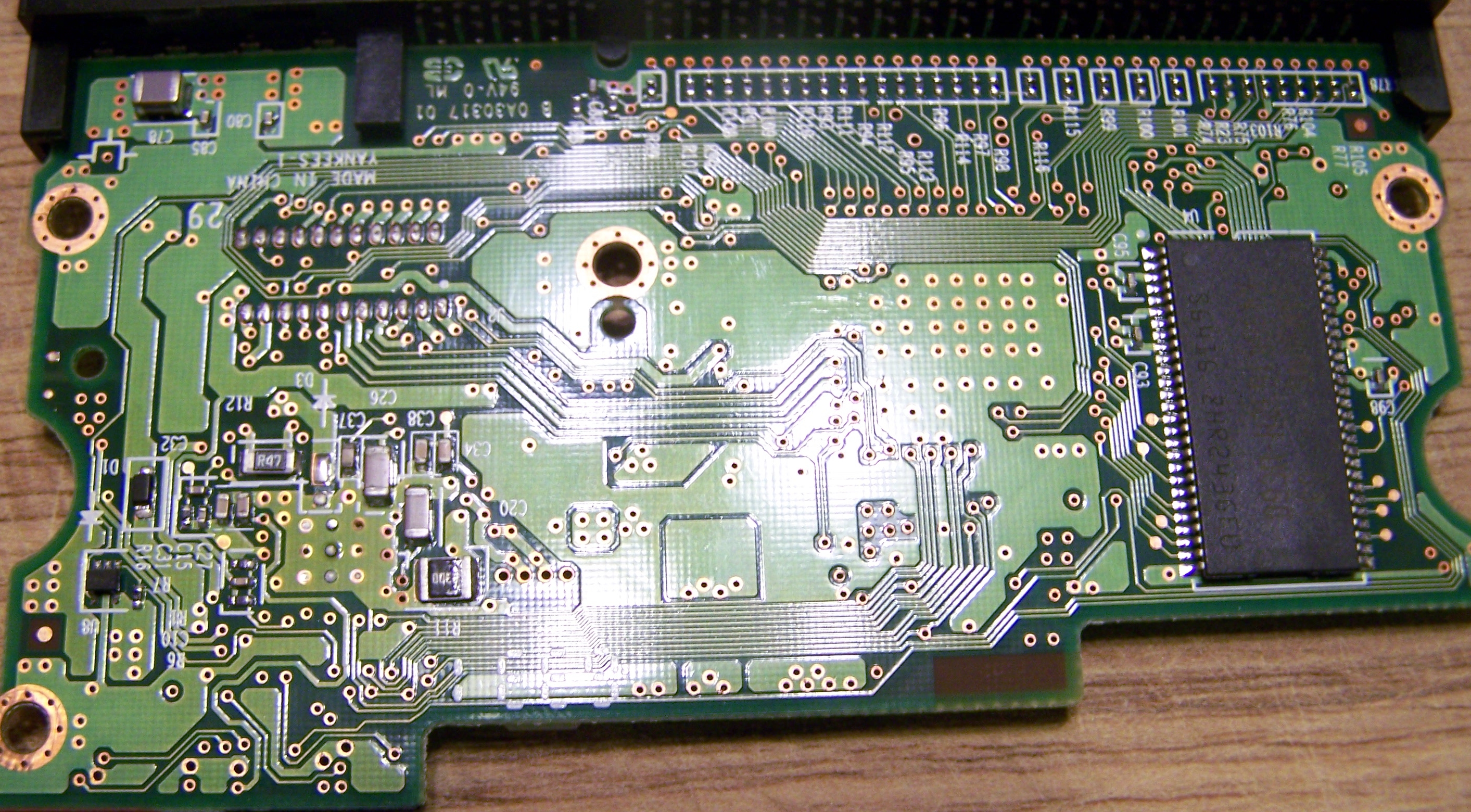

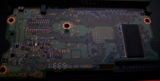

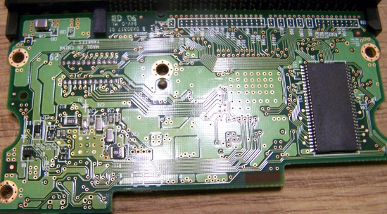

Re: Hitachi Deskstar HDT722525DLAT80 no spin
March 31st, 2011, 22:35
And some pictures of the back of the PCB. I tried to take some in different lighting for each.

Here are the various onboard supplies:
http://www.users.on.net/~fzabkar/HDD/HD ... _NVRAM.jpg
http://www.users.on.net/~fzabkar/HDD/HD ... Preamp.jpg
http://www.users.on.net/~fzabkar/HDD/HD ... io-reg.jpg
http://www.users.on.net/~fzabkar/HDD/HD ... eg-reg.jpg
The first thing I would do is to measure the resistance of the 12V TVS diode (D2) near the power connector. I expect that it's OK -- if it were shorted, then your computer's PSU would have shut down.
I would then measure the resistance between ground and each of the Vio1, Vio2, Vcore, +5V, and -5V supplies. This will tell us if there are any shorted loads.
If there are no shorts, then power up the board on its own and measure the voltages at Vcore, Vio1, Vio2, and -5V. I expect that Vio1 will be +3.3V. I'm guessing that Vio2 will be either +1.8V or +2.5V. Vcore will probably be around +1.5V to +2.1V.
BTW, I'm assuming that the board is the original one. At least the date codes on the stickers and MCU are similar to the date code on the bridge board.

ryvix wrote:Voltages:
Vcore - 3.29
Vio1 - 3.29
Vio2 - 3.29
-5V - -3.02
It doesn't match your guesses all the time so I hope I did it right.
It looks like I guessed wrong. :-(
Can you measure the voltages at the centre pins of Q1 and Q3? Are they +5V as I suspected? If not, then they could be the Vcore and Vio2 outputs. This would make Q2 the main +3.3V Vio1 regulator, with the remaining voltages being down-converted from this supply.
As for the negative preamp supply, the -3V reading may be correct. I'll be getting some Hitachi PCBs soon (different model) and I'll compare the readings.
April 11th, 2011, 8:13
Voltages at center pins:
Q1 - 1.54
Q2 - 5.08
Q3 - 1.58

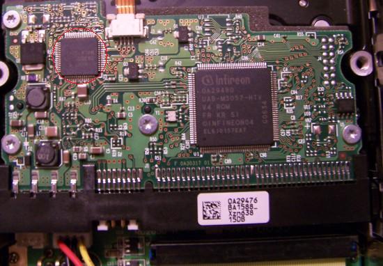

April 11th, 2011, 9:46
Change the IC circled and your problem will be solved.
April 11th, 2011, 10:53
I recommend Luke at Recovery Force for getting a real diagnosis and solution
April 11th, 2011, 20:55
If all else fails, the most expedient DIY solution would be to purchase a compatible PCB and transfer the chip at U5 to your donor. Your local TV/AV repair shop should be able to handle this simple task.
As for the measurements, thanks for your patience. It's now clear that Q2 supplies the +3.3V Vio voltage. This rail supplies the vacant flash memory location at U7, and probably the serial EEPROM at U5. What is the part number of the EEPROM? What is the resistance between its Vdd supply pin and the Vio pin of Q2?
Q3 and Q2 both down-regulate the +3.3V supply. Q3 provides a +1.6V supply (Vcore?) to the MCU. Q1 supplies some other logic with +1.5V. Without knowing their actual values, ISTM that the Vcore voltage is within the ballpark, but I'm not sure of the other rail.
Could you measure the voltage at the supply (bottom left pin) to the SDRAM on the underside of the board? Could you also measure the resistance between this pin and the centre pins of Q1 and Q3? This will tell us which regulator is powering the SDRAM. What is the part number of the SDRAM? Its datasheet will tell us its rated supply voltage.
One final measurement. Could you measure the resistance between the centre pins of Q1 and Q3? This will tell us whether the two rails are shorted to each other.
As for the motor controller, it also controls each of the above regulators. Therefore, even though it has several additional functions, I don't understand why it would be a suspect, given the above information.
April 29th, 2011, 9:22
Hi there,
I'm sorry for not responding sooner, but I have been very busy and haven't been able to answer all your questions so I held off until I had some time and could actually see those part numbers.
If this is that little black box above U5 then its really hard to see but I think it is:
S93C76
ADVFS
7834
I don't know if I did this right but the pin on the top left of the box at Q2 read 001. The pin on the right read 568. The center pin is 591.
3.29
This wasn't the easiest thing to do, now I think you are just giving me little challenges =)
Q1 735
Q3 837
If I am looking at the right thing:
SAMSUNG 631
K4S641632H-UC60
S6416 ZHR243GFU
1114
Thanks again. This is actually kind of fun in a way.
May 1st, 2011, 19:54
Your measurements confirm that Q2 is the pass transistor in a linear +3.3V regulator. The S93C76 NVRAM and K4S641632H SDRAM are both powered from this supply.
K4S641632H-UC60, Samsung, 64Mbit SDRAM, 3.3V:
http://www.datasheetarchive.com/pdf/get ... .pdf&scan=
S-93C76A, CMOS SERIAL E2PROM, 8K-bit, 512 x 16, Seiko Instruments Inc.:
http://datasheet.sii-ic.com/en/microwir ... C76A_E.pdf
http://www.datasheetarchive.com/pdf-dat ... -41509.pdf
As for the other supply rails, I can't see any obvious faults, but my next DIY step would be to purchase a replacement PCB and compare its Vneg, Vcore and Vio voltages against your own. Your last DIY resort would be to transfer the NVRAM chip to your donor PCB. Since its Vdd supply is intact, there is a good chance that this chip is OK.
