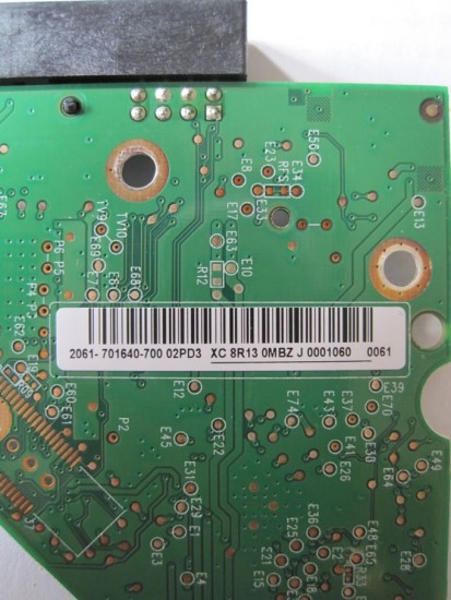

Hi all,
My External Caviar Green HDD is not working. When plugged in you can hear the drive try to spin up and then there are 3 sweep/click noises with about a second gap in between. It does this another 3 times after that, and then the drive powers down.
I connected it internally on my desktop PC and it does the same thing.
It shows in Device Manager as just "WD Elements" only, whereas before it used to have the whole code after the title.
WD10EADS-00M2B0
Date of Manufacture: 15 AUG 2009
DCM: HBRCHV2CBB
R/N 701640

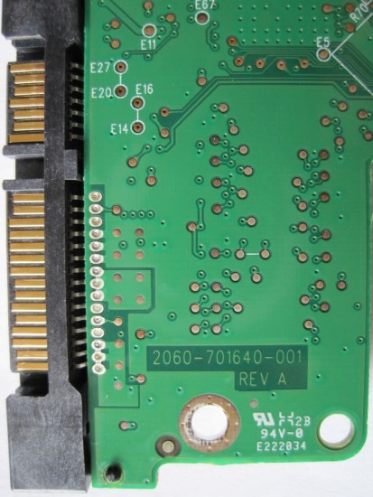

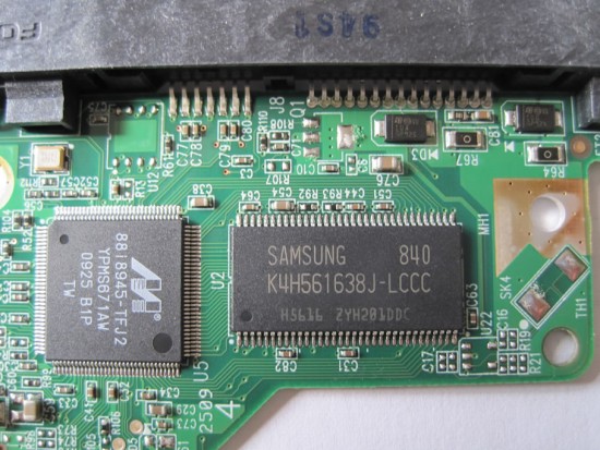

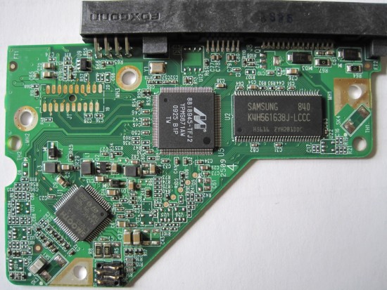

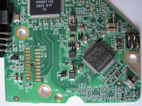

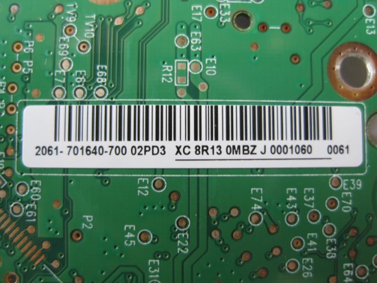

I took some pics of the PCB, and wanted to ask some advice on what to do next to try and recover my data. Do you think a replacement PCB will help me, and if so does anyone know of a good place in or near the UK where I can buy one?
Many Thanks all
T
Re: WD10EADS tries to spin up a few times and then stops
April 1st, 2011, 12:08
tony924 wrote:Do you think a replacement PCB will help me
No, sounds like a physical problem
April 1st, 2011, 12:57
Agree with DRC this happens a lot with WD and more times than one they are head problems on these drives. Not too stable these drives. Changing out the PCB will not help you in this one. Sorry but you will either have to RMA this HDD or take it to a recovery shop who knows these drives well and the head alignment issues inside of them to get back your data. Not much choice and more than likely not what you wanted to hear on this one.
