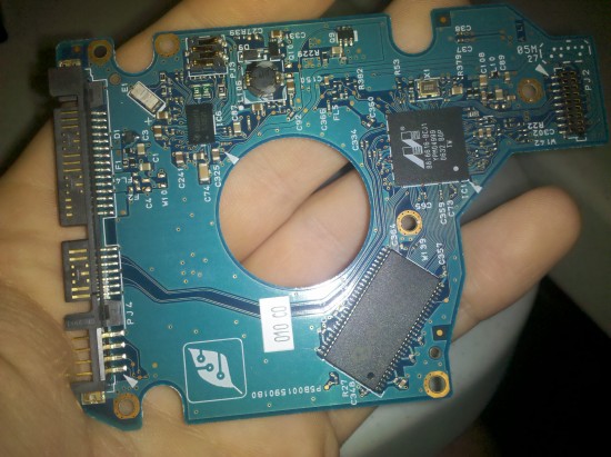

I have a Toshiba model MK1234GSX with a code of HDD2D31 D ZK01 T. With the patient PCB attached the drive does not spin up, but with a donor PCB the drive spins up (but never goes ready). Was wondering if anyone could give some insight as to possible TVS components on the attached photo. I'm thinking D1 may be one, but don't want to remove anything until someone else can chime in and confirm that. No visibly blown components from what I can see under a magnifying glass.

Check "F1"

There is a 4A fuse, F1, near the SATA power connector.
Littelfuse Surface Mount Fuses, N = 2A, S = 4A:
http://www.farnell.com/datasheets/48294.pdf
There is also a 5V TVS diode at D1.

Dizidago357, let me know if you are prepared to take some simple measurements. This will verify whether there are any shorted loads on any of the onboard DC-DC converters.
BTW, these SMT fuses are known for nuisance tripping. If F1 is open, but D1 is intact, then I would suspect that the rest of the board should be OK.

I'd set your DMM on the 200 ohms range. Measure the resistances of F1 and D1. If D1 is shorted, remove it with flush cutters.
Now measure the resistance between ground and each side of F1. This will tell us if there is an excessive load on the +5V supply.
Measure the resistance between ground and the 4R7 coil (L106). This will test for a short on the DC-DC converter consisting of L106, Q10, and D9. I suspect it provides the Vcore voltage for the Marvell MCU.
Also test the resistances between ground and each of the pins of Q9. I suspect that Q9 is the pass transistor in a linear supply, probably supplying the Vio for the MCU and SDRAM.
If all is OK, then the next step will be to measure the voltages at F1, Q9, L106, and the preamp connector, PJ2.

F1 and D1 both test OK. The difference between your two boards is insignificant. The different result for reverse polarity is to be expected for a diode because it conducts in the forward direction but not in the reverse direction.
For your other measurements, you can use the ground pins in the SATA power connector:

If anything, the coil is bad on the donor, assuming you've performed your measurements correctly. The DC resistance of your coil should be close to zero.
I don't understand why Q9 tests differently on the patient board. In any case nothing appears shorted on the patient, so it should be OK to measure the voltages at Q9 and L106. I'd use the neighbouring plated through-holes as the test points, rather than the pins on Q9.
BTW, I'm assuming that you are looking at the PCB with interface pins facing upwards, not to the left as in your photo.
