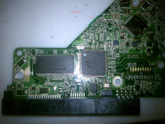

I have three Western Digital WD15EADS. A lighting storm hit and fried my sever and everything in it. I looked at the PCB and the same chip fried on each board.
I found the website hdd-parts.com but they do not carry the board I need. Can anyone help?

Here is an image of the PCB chip that burnt. It as the same chip on all 3 boards.
Chip that fried

You are lucky in that your board has an 8-pin serial flash memory IC at location U12. This chip, or its contents, needs to be transferred to your replacement board. Your local TV/AV repair shop should be able to do this for you. Otherwise some PCB suppliers will include a firmware/ROM transfer for US$10-$20, or even for free.

Move the U12 to Donor PCB and ur done
thats all
and plug and pray , nothing else is defected :wink:

If your data is valuable, I think you should go into a pro, as any other actions could result also in further damage.
If it's not too valuable, you can try to find a donor PCB and swap ROM chip (U12).

I've found that with newer drives it's harder to get just the PCB, you sometimes need to buy the entire drive as a donor.

What I meant was that it's hard to find someone who will stock/sell just the PCB of a newer model drive, as these drives haven't been 'retired' yet. ie. you might need to pay for the whole drive, not just the PCB.
Yes, you'll need to match the PCB number as well as swapping the 8-pin U12 chip.

AIUI, the DCM number is important when matching the internal parts, but not when matching the PCB.
BTW, your problem really only requires a simple board swap and chip swap (or reprogramming in situ), not a "data recovery". If the DR centres are gouging you for this trivial service, then look elsewhere. If you take hdd-parts.com as your guide, then you shouldn't need to pay more than $70 per board. In fact you should be able to use the one board for all three drives (with three chip transfers).

without checking preamps u put your data to risk if u just replace PCB even with ROM transfer
