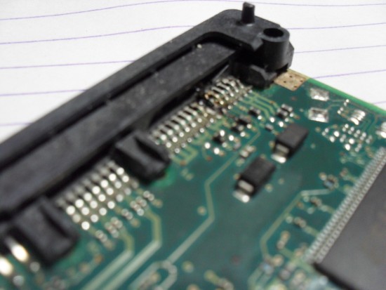

My HDD suddenly smoked and the SATA power port was badly burned. This was all while I was browsing the internet and doing some pdf creation. Is there any way to recover my files cheaply? I really need it for my undergraduate thesis and I am about to graduate this semester (but due to this hdd burn). I have read board replacement but I need to resolder/solder the rom back. :(
The burned port

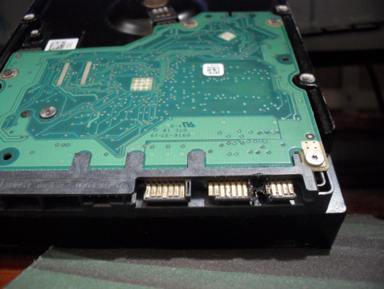

June 17th, 2011, 2:12
labtech wrote:Post picture of the other side of the PCB, please.
Here you go :)
That's the close up photo of the back side. No other burn marks aside from that part.

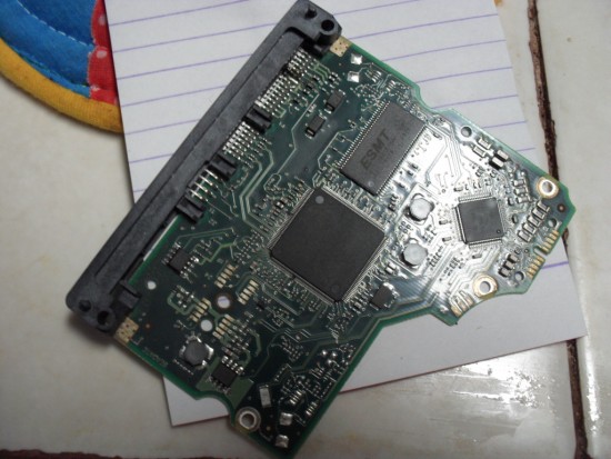

Re: ST31000528AS burned SATA power port
June 17th, 2011, 11:18
DR-Kiev wrote:Seems to me, most of all important components had burned too. Show full picture, not just interface part.
Here are the pics sorry they are blurred due to low lighting conditions

move rom to donor
June 18th, 2011, 13:49
einstein9 wrote:move rom to donor
I am sorry but what is the ROM chip on that board? I don't really repair HDDs but I am quite knowledgeable on ICs and PC parts. I'm afraid that I might damage the pins of the ROM chip too.

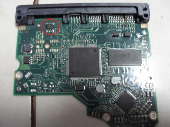

Here..

June 18th, 2011, 21:27
The bottom of the board is showing damage to the +5V and ground pins at the SATA power connector, whereas the component side has damage to the ground pins.
The first thing you should do is to verify your PSU, particularly its +5V output.
Then measure the resistances of the two TVS diodes using a multimeter set to the 200 ohms range.
The following photo clips should help you identify the components:
http://www.users.on.net/~fzabkar/HDD/ST ... AS_TVS.jpg
http://www.users.on.net/~fzabkar/HDD/ST ... AS_fix.jpg
If you need to replace the board, the following suppliers include a "ROM" or "firmware" transfer service:
http://www.onepcbsolution.com
http://www.hdd-parts.com
I believe one board supplier on this forum may offer a free service, although he doesn't advertise it.
That said, if you are looking for a cheaper solution, and you are prepared to take a big risk, then you could solder a 4-pin Molex peripheral connector to the SATA power pins.
Here are the pinouts:
http://pinouts.ru/Power/BigPower_pinout.shtml
