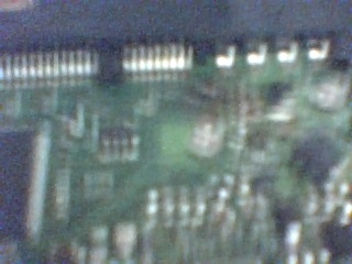

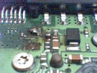

I have hardisk that 1 of ic in pcb board is burn maybe it is because a power supply is unnormaly...
can I change ic with another hardisk?
that the photo
Picture 32.jpg (27.88 KiB) Viewed 4865 times
Picture 31.jpg (29.4 KiB) Viewed 4865 times
please help me... user say to me that data must be back....
sorry my english not to good i am from Indonesia...

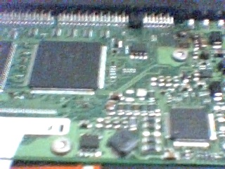

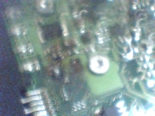

this an image again

If the preamplifier chip on the head stack survived - then yes. You should be able to get a donor board in , move the rom and retreive the data.
Re: [help]my seagate baracuda 7200.9 st3160212A burn
August 16th, 2011, 14:54
Alexii wrote:If the preamplifier chip on the head stack survived - then yes. You should be able to get a donor board in , move the rom and retreive the data.
Agree, in moving the ROM to donor
i guess those images been taken by Mobile CAM maybe,, quality is so bad
good luck
August 23rd, 2011, 1:49
so i must get same type hadrdisk and change the boards...
so i cannot only change the ic?
thanks...
