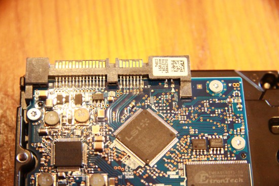

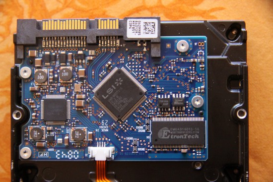

I need advice in electronics. I got yesterday a non working Hitachi 640GB.
It's spinning well, no particular noise. I first thought it was firmware issue, or wrong PCB exchange before it comes to me.
I asked for the PCB exchange, nothing like that.
I then noticed that nothing happened (I mean no sync noise, no head moove) when hot plugged/unplugged the sata cable.
Looking the PCB whith magnify lenses I then noticed that 2 little capacitors (I think it's caps, but not sure) were missing. They are "in line" just under data connector, on pins 2 and 3.
First question : Are that caps mandatory composants or only for protection ? I mean : May I short them just the time of data extraction ?
Second question : If I need to replace, Does someone knows what's the capacity ?
Last, but not least : There's an external eeprom on the board. If I decide to swap board, I bet eepom swap is needed too there ? Isn't it ?

post a clear image of the PCB
Re: PCB Repair - HDT721064SLA360 - advice needed
September 25th, 2011, 4:37
Hi einstein9,
Thank you for your help.
Here's the pic :
September 25th, 2011, 4:50
Well those 2 missing are a Must, if you are good in Soldering this will not be a problem
did you try to get both back from any dead hard disk?
no need to change your PCB really but those 2 belongs to the DATA
my advice, solder both back
good luck

TY for precicion. I did not try, waiting for advices, because it would have been easier to short ;)
I've a potential donor, I'll try and let you know.
I just wonder how this could have happened, because the disk was inside a computer. They told me it stopped "working", and after that they took it outside the computer.
Perhaps will I face another problem after soldering. I'm quite sure they distroyed the caps while removing the disk…

Wooops, one question again, before doing mistakes…
When I unsold TVS, I usually put iron or hot gun to about 280°c (536°F). I wonder if such a temperature would not destroy a so little capacitor.
Is unsolder tape needed there or just hot gun and tweezers should be enough ?
September 26th, 2011, 5:52
Auto answer : tweezers, iron and little pin are enough.
TY again for advice einstein9 : It's now working fine ;)
Not so easy, but result is'n so bad…
