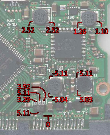

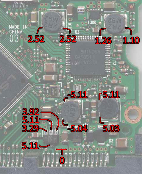

Hello again fzabkar, and thanks for your help.
I made the measurements, and attached the image with the resulted voltages. Everything was tested with respect to the 0V point at the bottom. And the voltages tested at the power connector were:
+5: 5.11
+12: 12.17
Please let me know if you find anything suspicious!
Best regards,
JC
PCB Measurements
Re: Hitachi HDT721010SLA360 not spinning - TVSs OK
February 5th, 2012, 15:55
Q2 is the +3.3V linear regulator for one of the Vio supplies.
L1 and L2 are part of the -5V Cuk converter for the preamp.
L310 provides the +2.5V Vio supply.
All appear to be working correctly.
L300 provides the Vcore supply for the MCU. I suspect that +1.1V is correct, but I can't be certain.
In short, I can't see any DIY solution. :-(

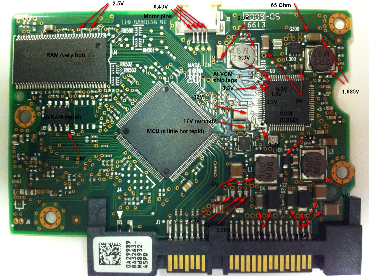

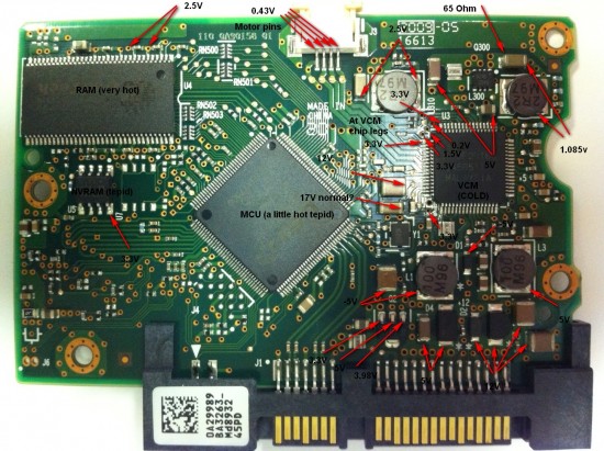

Hello, i have the exact same issue with my Hitachi HDT721010SLA360. Its not spinning at all, the TVS are all good (not shorted). I've measured a lot of voltage and resistance around the PCB. fzabkar can you help check if you see something suspect here?
I wonder what could prevent the motor to spin? I think the fault is on the PCB, because the VCM chip is probably not able to start the motor, but the question is why? I've read from member poehere that the Hitachi Deskstar HDD are prone to fault with the VCM chip. Is it a known issue? Where is exactly the issue? Inside the IC or outside on some other component?
The VCM chip is maked OA56511.
Thank you for any help.
October 9th, 2014, 17:13
All the voltages appear OK.
    Vcore = +1.085V
    Vio1 = +3.3V
    Vio2 = +2.5V
    Vneg = -5V (preamp supply)
    Vboost = 17V (charge pump for VCM and spindle motor)
I believe the SDRAM should normally run cool.
ISTM that the most expedient approach would be a PCB swap and NVRAM transfer. If you have some way of reading the NVRAM chip, then we could verify its checksum (XOR8 ?).
October 10th, 2014, 11:54
ok I started to read your documents and there are very interesting. it is by far the deepest analysis of PCB Electronics I have ever read. Ive measured a voltage of 0.43v on pin a b c and common of motor pins and 1.9 ohms between phase to common pins and 3.6 ohms between phase to phase as expected based on your document. I think probably the motor driver chip is not sending the order to spin to the motor for some reason...
Maybe the feedback circuitry detects somethings wrong? Is there a test I can do to be sure its not the motor that is dead? Can I force some voltage using external PSU to start the motor? But I guess its not that simple because I'd have to generate a good pwm signal on the rights pins its not do-able?
