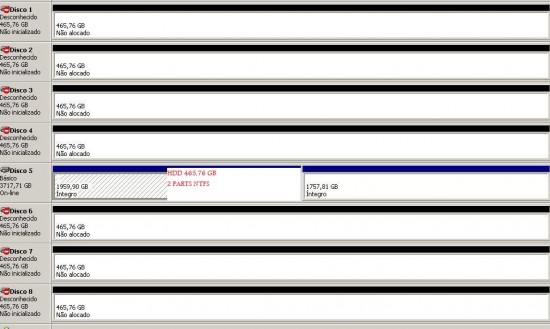

LOOK.....

Is the drive order correct?
you can try two different products from Runtime Software call Raid Reconstructor ( it might work) or a slightly better version of it called Raid recovery for windows. See if it can pick up the correct order and stripe size.
Re: RAID 0 8 DISKS
February 8th, 2012, 6:57
Check consistency in MFT records.
For RAID0 with many disks is really only way unless you get lucky with automated software.
