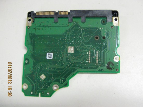

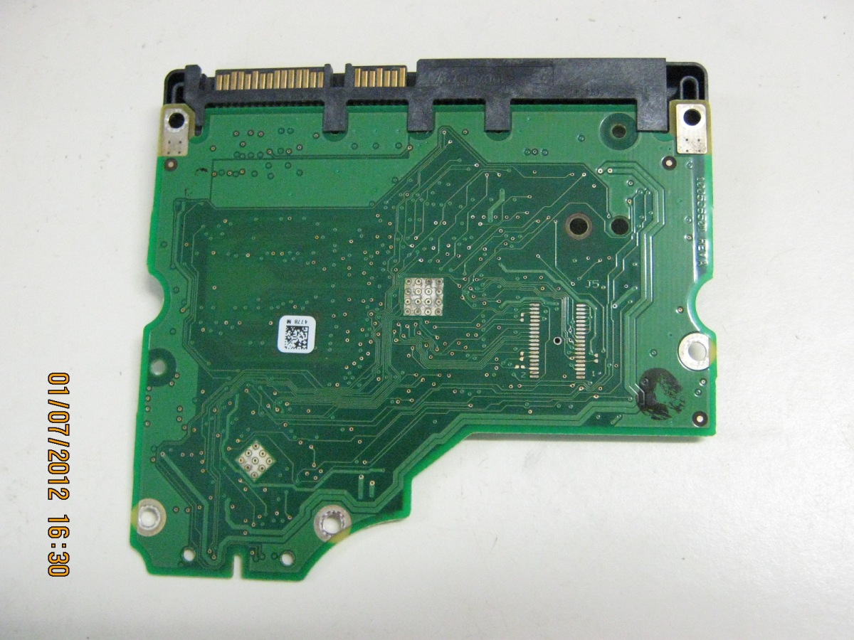

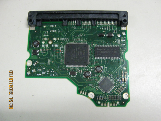

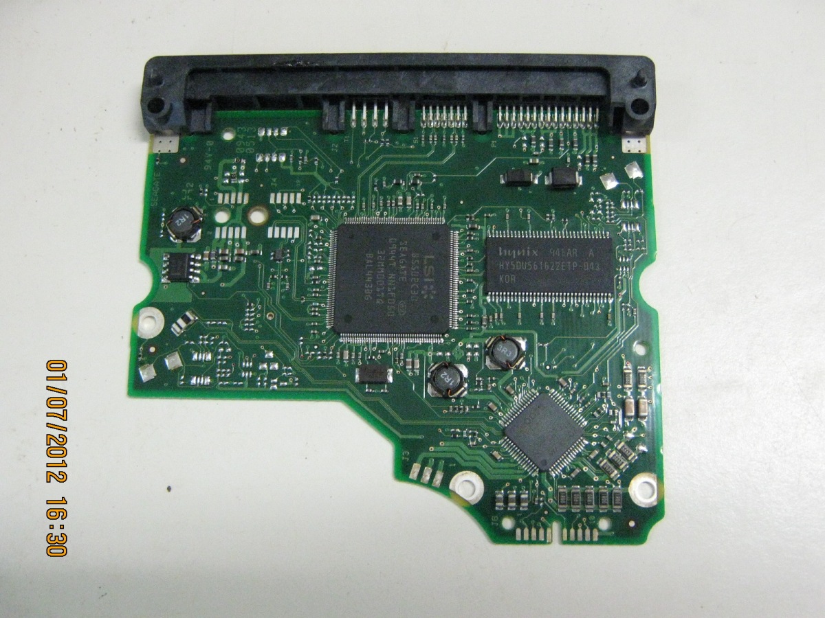

Hi
Does anyone happen to have an image of the short location on above board for LED CC Short procedure?
Scott

Can you post a pic of both sides of the board?

July 1st, 2012, 7:45
Pictures of PCB attached
The procedure was recommended by pc3000 support staff when terminal access is blocked.

Re: Seagate 100536501 REV A LED CC Short Pin Location?
July 1st, 2012, 13:18
Since you have a PC3000, the procedure for determining which points to short is in there. You should re-read that section so you can solve this one without help next time.
Here are the points:
