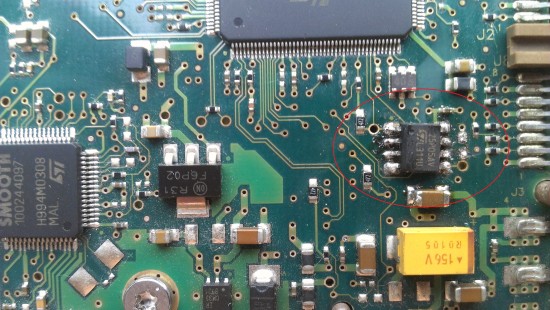

I need some help on the above model HDD.
it is 80Gb P/N:9w2003-301
It was not spinning at all, so I bought a used working PCB... I replaced it and still nothing. I swapped the BIOS (firmware chip) so to have the old firmware on the new board and still nothing. The HDD remained dead.
Anyone can help me maybe more answers?

So the Hdd does not switch on, does not spin and no sound atall. After the replacement of pcb and bios

Well then either your ROM is dead or the transplant of the ROM chip was not done properly (or the new PCB is dead as well).

the seller where I bought the board said he tested it and it was working before sent to me... Maybe I can try to remove the BIOS chip and re solder it...
attached I sent a photo of the soldered BIOS

That's a poor/messy solder job. How sure are you that the ROM swap didn't damage something?
The seller said it was working before he sent it to you. Was that before the ROM was swapped? I would put my money on the soldering process as the culprit here.

Just connected the HDD directly into the motherboard, as before I was connecting it to my external adapter... Now it worked with the swapped "new board". so its the external enclosure that its faulty then.
