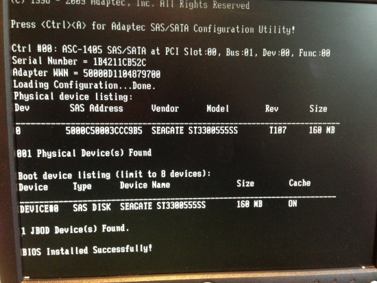

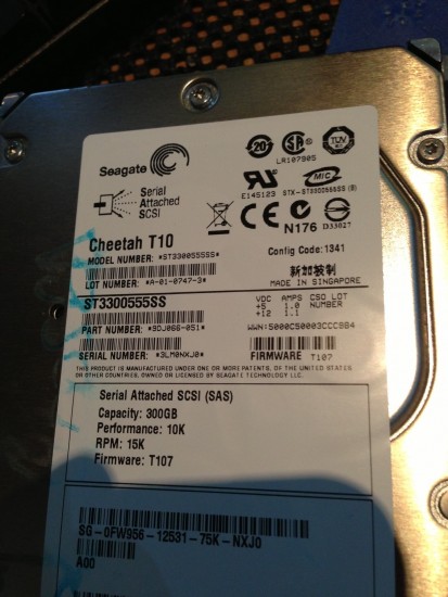

300GB Seagate SAS ST3300555SS showing as 160MB at post
December 13th, 2012, 16:34
any ideas?
thanks in advance
andy

From HP server by a chance (on caddy) ? :mrgreen:
Re: 300GB Seagate SAS ST3300555SS showing as 160MB at post
December 13th, 2012, 16:41
Dell mate. Got it on an adaptec 1405.
3 disk raid, other 2 cloned fine

RAID 0? Little strange...
December 13th, 2012, 23:21
Could 160 be the connection speed? And maybe you mistakingly think it's the shown capacity?
These drives usually show either full capacity or capacity 0
Not an easy model to deal with

December 14th, 2012, 7:49
had a couple 0MB ones too, weird isnt it
will get a screenshot
thanks
andy
December 14th, 2012, 7:55
screenshot
December 14th, 2012, 11:04
Weird, indeed.
Usually it was a go/no go (0 MB).
