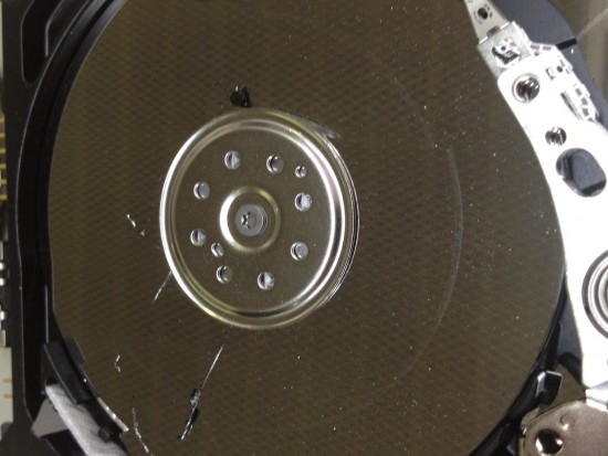

Today I received an e-mail from a gentleman who had sent his drive to another recovery company in my area. He asked, based on the photo provided to him by the other company, whether I thought there was a chance of recovery, as the 'attempt' by the current people was not successful.
The information this company provided him with was:
"It is with great disappointment that we inform you that all attempts to recover your data have been unsuccessful due to media damage on the hard drive.....
Our most sincere apologies for the long wait, we wanted to make sure we had tried all options before we could call this a No Recovery Job..."
Fair enough, we see media damaged drives all the time that are beyond recovery. However, have a look at the picture they provided. In my opinion there is no chance of recovering that drive. Cracked platter, pieces of the outer platter broken off, heavy damage nearer the middle, contaminated to hell, etc etc.
How do you justify telling your client that 'all attempts to recover your data have been unsuccessful"? I most certainly wouldn't touch a drive in that state I can also imagine the 'long wait' whilst the customer was made to believe that there was some hope at all. Rather give the customer the bad news and move on.
This is either crap customer service; they have the 'magic platter fixing put-back-together-the-pieces device' that I don't; or they actually attempted the job. My money is on option 1.

Generally in this situation my guess would be it didn't look like this until after getting worked on
That's pretty messed up though, hard to imagine what someone competent could do that would end in that

My issue here is as the title of the topic suggests. The picture obviously indicates the drive when it was first opened (no way would it look like that after 'recovery was attempted' by a long standing recovery provider, if that's after you've attempted to recover then you should be shot) so if this is what the technician saw upon opening the drive, why give the customer false hope? Why 'attempt' recovery and then, after a long while, say that after all our attempts we were unsuccessful, when clearly you haven't even done anything to it as there was nothing that could be done anyway?

The drive in the picture shows a defined ring approx halfway in.... along with the quite obvious and fatal damage, could this possibly indicate 2 events.... i.e. the fatal damage occurred after the initial failure, and it was this initial failure that may have been the focus of prior attempts at recovery....

Could it be that the other lab tried to see if they could get anything off the bottom platter? It is quite clear that they would have no success with the top.

The guy who the drive belongs to called me earlier today to ask me my opinion on it. The company in question first quoted him about $700 which he rejected, then kept dropping the price until it reached about $200 at which point he accepted. I hear this often from clients who have interacted with this particular place, that they quote high and then barter with client, sometimes down to 25% of the original quote, until the client accepts :lol:
Bottom left of the photo shows a chunk of the outer platter edge completely missing and platter is cracked along almost the entire radius. I doubt for $200 they attempted anything on this drive. Ultimately I feel sorry for the owner of the drive who is really upset by the whole event.

This makes absolutely no sense. Why would they even bother dropping the price on an impossible project? It certainly would make sense for them to sabotage the drive, as the client did agree to a price for them to move forward with. The only thing I can think of is that the lab didn't bother physically assessing the drive prior to quoting, thinking that it was going to be an easier project. Then they either screwed up (which would have to be pretty severe to cause that much damage) or they then opened the drive to see the surprise inside.
