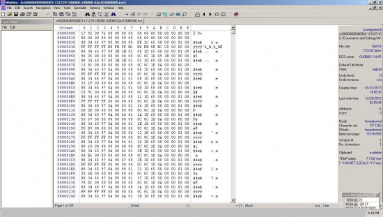

I have recovered CCTV footage from a DVR & want to play it on pc ,I tried to search for playback tool ,but could not locate one. Customer gave me only hard disk so I dont know make of DVR as well.
I would like to know how to play .nvr files. Thank you

post here the header from winhex & will see
Edited, FYI, DVR`s record RAW Data
Re: How to play .nvr files
January 23rd, 2013, 7:28
Thanks a lot einstein9
attached is snapin winhex as well as file blocks,hope to get it decoded.
January 23rd, 2013, 9:04
i`ve tried my DVR Player on many other brands (playing those RAW) and worked
but the problem is mine is Licensed which cannot share with others (comes with the PSS App.)
and your file here is supported (tested it before and wrote my note about the header)
the question for you now is HOW?

January 25th, 2013, 0:59
Update for this case
These files does not contain any audio /video Data.They are indexing files created by DVR to keep track of sectors used.
This could be useful for everyone doing dvr related recovery
February 4th, 2013, 3:31
Regret I was completly wrong in analysing these files. My earlier conclusion is wrong.
.nvr files indeed hold large data.They are actually .264 files.
February 4th, 2013, 5:17
TaskManager wrote:Regret I was completly wrong in analysing these files. My earlier conclusion is wrong.
and RAW recording data
