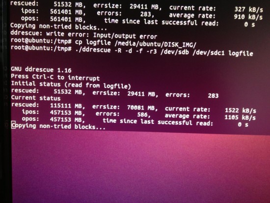

I am now running ddrescue to image this drive, estimating it will take a total of 8 days at its current transfer rate. The drive keeps getting into areas that triggers the clicking/head panning every 20mb or so, but never shuts down. Is there a way to disable heads on trial and error basis, to isolate the bad ones, using MHDD or some other free utility? And can someone tell me if the error rate that I am getting means that I may get 1/2 the files or 1/2 of "data" with very little chance of any whole files (once I start carving)?
I am attaching a screenshot of ddrescue session. On occasion I have to relaunch it after it quits from I/O errors, but so far it always managed to pick up where it left off.

@Ysbelman1,
I agree with Cleanroom and he's answered most of your questions. I'll just add that the ddrescue command line shown is unlikely to be the quickest one, but that may not be important to you (except that as already explained to you, your continued DIY could make things worse).
If your friend chooses to give permission for you to potentially kill the original disk while trying, then I'm concerned about the ddrescue error shown on that screenshot. It's a write error, meaning (in your case) a problem writing to either /dev/sdc1 or to "logfile" (I don't have time to check the ddrescue source code right now, to see if that specific error message gives more clues). Neither of those locations should report a write error, so there is something fundamentally wrong in your setup, or with that system. Then you copy the logfile to a mounted filesystem, and run ddrescue again, using logfile - so why copy it to that filesystem... I don't understand. Anyway, if I was getting write errors while using ddrescue, I would find & fix the cause - otherwise you might end-up losing the clone which you are trying to create (if, for example, the drive which is you /dev/sdc1 is failing). Check for errors logged in dmesg related to /dev/sdc1 or logfile, if you haven't already.

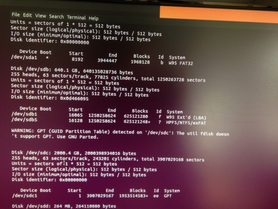

With the write errors...is there any chance you are cloning in the wrong direction? It might not hurt to do an fdisk -l and post the screenshot too.
Re: Ddrescue with damaged heads.
February 28th, 2013, 14:15
Lcoughy, way to go to scare me :) I had to go back and double check my mounts. I think I did that right, at least. /dev/sdb is 640gb source drive, /dev/sdc is 2TB clone target. But very good point, which I missed, that it was a write error, not read. It may have occurred around a time I was running >df on the target drive (maybe expecting it to change in usage statistics, but it probably is correct to stay at near zero used as ddresque image would not create files)
The logfile copy I am doing is just to back it up to another flash disk. I am running a live ubuntu from a flash on a barebones motherboard. And /tmp is in volatile memory. If this setup craps out on me, I will use the flash directly to keep track of the logfile. So far however no kernel panics and no shutdowns.

Ysbelman1 wrote:/dev/sdb is 640gb source drive, /dev/sdc is 2TB clone target. But very good point, which I missed, that it was a write error, not read. It may have occurred around a time I was running >df on the target drive
You didn't give the exact df command that you used, but because you chose /dev/sdc1 as the output file for ddrescue, you do realise that you are overwriting the first 640GB of that 2TB drive, don't you? There is no valid original filesystem (any more) on /dev/sdc1 (if one ever existed) - therefore I don't know what you were trying to "df" on the target drive, as "df" only works on filesystems (if you're writing to a device/partition as the target, then you cannot sensibly have any mounted filesystem on that same device/partition).

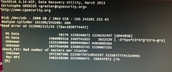

Now I am running TestSisk on target drive, yet another multiday process. Ugh! Attaching screenshot.
Does the result from TestDisk (quick scan) tell you anything ? The first line is "WD640GB", that has to be the image i am after. Are the rest of those entries - left overs from partitions that existed on the drive prior?

the target drive isn't in pristine condition as I thought
Should have tested it before cloning using MHDD
And erased it (using MHDD) to avoid data contamination
..next time
Hope you get your data though.
