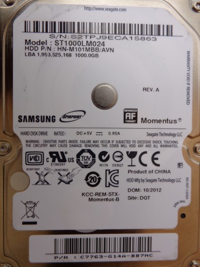

Hi everyone
Model : ST1000LM024
P/N : HN-M101MBB/AVN
cABACITY : 1TB
can't be access in terminal mode,
didn't open Ctrl-Z, Ctrl-T
error show in -BUSY
what maybe a proble pcb or anything?
please help.
Regards,
Aravind

Terminal will work, probably you need to read in Samsung utility, SA structure should be Samsung.
Also, baud rates are different, as are position of TX & RX so this is why terminal is not accessible
March 28th, 2013, 3:01
see the pic

March 28th, 2013, 9:22
hddguy wrote:Spildit wrote:I think that your drive is in fact a samsung HN-M101MBB, in other words, a SpinPoint M8 .....
At any rate Samsung drives also have terminal port ....
It is a Seagate with Samsung label...
it's the other way around
if it spins up and doesn't click then it's SA problem (common on this model). Use Samsung utility/connection to get serial port output
