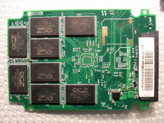

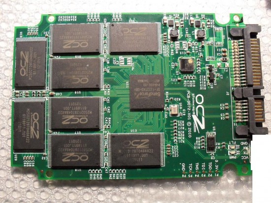

Hi guys, I have here a OCZ Vertex2 240GB SSD for recovery
When i plug it to my PC BIOS not recognize it wait about 1 minute but no t rcognize SSS.
I try with difernet PCs but the same way
I opened case and i can see Power Led continuously in Green and FLT initialy power up (RED) for a fraction of a second, then turns power off for 2 seconds and then power up continously (in RED).
I atach to tx/RX and i get this log:

SandForce controller inside?
Re: OCZ Vertex 2 240GB SSD for recovery
March 27th, 2013, 4:57
Yes SandForce controler
Info about Chip SandForce
CONTROLER
Sandforce
SF-1222TA3-SBH
P4H888.00
4610 TAIWAN
March 27th, 2013, 13:33
Hi einstein9
i was lookin into AceLab infor but Acelab not supports it
I include Pics
Any new idea?
April 2nd, 2013, 6:19
There seems no evident damage (from picture) but the garbled data you get on terminal output make me think about either malfunction / FW problem.
Out of curiosity does the Sandforce chip heat abnormally ?
April 2nd, 2013, 6:28
BlackST wrote:There seems no evident damage (from picture) but the garbled data you get on terminal output make me think about either malfunction / FW problem.
