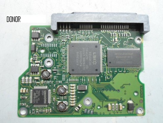

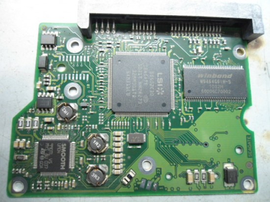

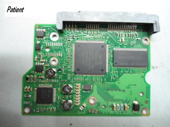

Measure the resistance between pin #4 and pin #8 of the flash chip.
Is your photo showing the damaged board or the donor?
Re: Rom chip
May 28th, 2013, 9:33
please Mr fzabkar
see these both pictures of patient & donor pcb & guide me

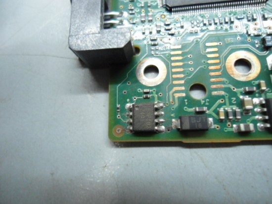

May 29th, 2013, 5:35
Mr northwind
see the picture.i have sold the Rom chip accurately.
but the problem remain same

May 29th, 2013, 9:47
I'm not sure pin #4 (which by the way involves itself into the power supply) is making good contact.

Wrong chip ...
NTMSD3P102R2, ON Semiconductor, marking E3P102, FETKY P–Channel Enhancement–Mode Power MOSFET & Schottky Diode, Dual SO–8, –3A, –20V, 0.085 ohms:
http://www.onsemi.com/pub/Collateral/NTMSD3P102R2-D.PDF
http://www.datasheetcatalog.org/datashe ... 02R2-D.PDF
