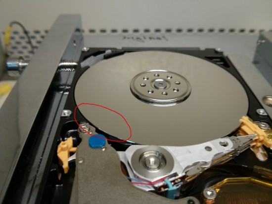

Hi
I git this drive, that had a stiction (the client said that there wasn't no crashes). I have unstucked heads, all seems fine on heads.
But I found 2 light scratches on the outer edge of the top platter.
I tried to see if it works, but it clicks.
Can it be heads or does these scratches affect the SA?

i think its Heads Try to swap Patient Heads to Donor HDA & see if its work then problem with Patient Platter Scratch.

Honestly I cannot see clearly the scratches from this picture, anyway inspect first with microscope and check with donor HDA.
Where were the heads "parked" ? (middle, OD, ID...)

They were parked in the middle.
The scratches are very thin.
If you zoom enough the image, you can see it.

Try to swap heads first. Then try to take an image as fast as you can.

Heads replaced and SQL database recovered.
Thanks guys.
