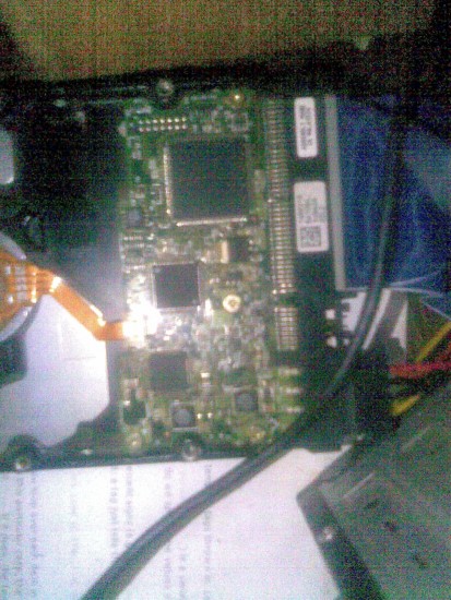

Hello, my old
Hitachi Deskstar HDS722525VLAT80 ATA/IDE
p/n: 14R9249
MLC: BA1140
CHS: 16383/16/63
s/n: cfdk9tkd
barcode: 14r9249ba11400s48
is not seen in bios anymore. It was working quite well, and now I cannot see it anymore. I did chip one data pin at some point on it but that has been fixed and it was working again. Also there may have been a power surge at the time of failure (electrical company cut the power to the whole block) but I am cannot be sure this is exactly what happened.
Thanks.
PS. IF you think a new pcb would solve my problem (i suspect it would) pls direct me to where I can get one and which one exactly to get. Thanks.

Re: Hitachi Deskstar HDS722525VLAT80 not seen in bios
June 11th, 2013, 15:56
Does your PCB look similar to this one?
http://malthus.zapto.org/viewtopic.php?f=112&t=103
June 12th, 2013, 0:55
you are correct. It is almost identical to the first pcb in that foto. I am upping a picture of the hdd right now. The quality is not great my phone only has a 2mp camera. If you need it clearer let me know and i will do my best. thanks.

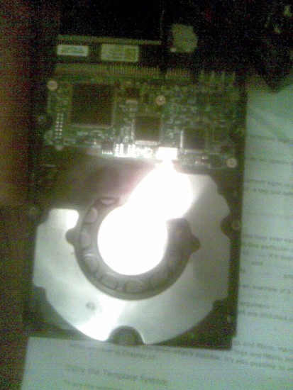

June 12th, 2013, 1:54
another one with slightly better light.
June 14th, 2013, 3:03
Sorry, I can't make out anything in your photos. In any case I can't see any "voltage protector" on my PCB. If you wish to try a new PCB, then be aware that you will need to transfer the NVRAM chip. That's U5 (S93C76) in my photo.
