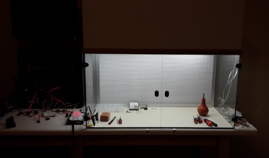

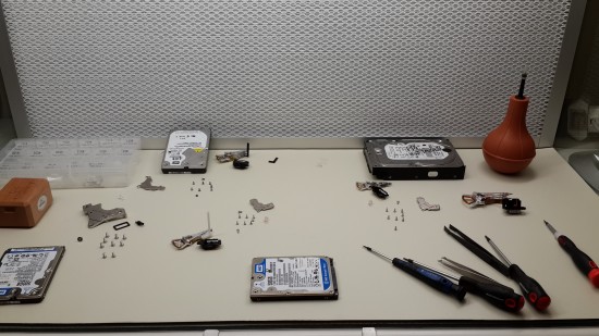

It's possible to build a safe working environment yourself, DIY, if you're prepared to put in the time and use the correct components. In the past I've build a work environment which uses a Class 14 HEPA panel, 2x Vortice fans with pre-filters. The joy of building an environment yourself is that you can spec it up to your own requirements in terms of lighting, anti-static precautions, air flow, etc.
Images attached for interest's sake.
