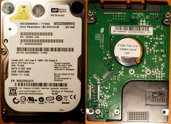

Hope someone can help me out with this.
My Western Digital drive wont boot, it sounds strange for approx 30sek-1min before it shuts down.
Modelinfo:
WD3200BMVS-11F9S0
You can listen to the sound here:http://web.comhem.se/webdrop/drive-192.mp3
What do you think could be wrong?
Thanks for any input on this!

From the sound and description I would say that heads failed (1 or even all), that's why it spins down, after calibration attempt.
The drive has to be checked and diagnosed by a professional, as I think it's even better to check if internally.
I'm sorry, but it's not a DIY case.

Thank you very much for the answers! I have of course backup of the data, was just hopeing the disc could be saved as its the only usbpowered I got.
Cheers
Re: WD3200BMVS strange sound/wont boot
September 2nd, 2013, 11:06
So in that case I think best option is to replace it.
