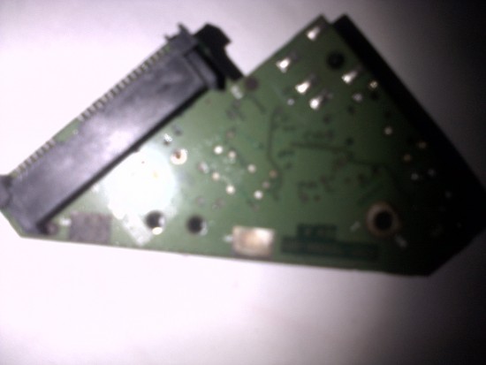

Pictures of the old board [if anyone interested]
Sorry for the quality, it was taken by quite old blackberry camera only
[spoiler=board]
[/spoiler]

i hate to be a drag but i really need my 3Tb data for submitting some of the works i had.... :(
Re: WDC MyBook 3 Tb Replaced Enclosure Board and Data
October 1st, 2013, 16:20
I'd like to help you, but your photos are useless.
October 1st, 2013, 16:33
yeah, need better pics, not much we can do, sorry.

Anyway, here's some picture i took, i hope this one is better
Thank you in advance

I'm assuming your screenshots were obtained with the drive attached to the eBay bridge board, rather than to a SATA port on your motherboard. I notice that DMDE is reporting 5.8 billion LBAs at 512 bytes per LBA. Bridge boards for 3TB My Books are normally configured with 4KB LBAs, although this can be changed by WD's formatting utility.
I'm wondering whether your eBay bridge board was configured for a 2TB drive or smaller, rather than for a 3TB drive.

1. Does your HDD spinning up, being connected to faulty bridge PCB?
2. Which connectors, with exception USB3, your faulty bridge board have? SATA? ESATA?
3. Did you tryed them?
4. What happening in WINDOWS device manager list, when you plugging in your faulty bridge board? Do you see any changes?
5. How your old bridge board became faulty?
October 6th, 2013, 8:33
Hi mamamiaw,
If HDD is spinning, you can hear a specific noise from it. Do you hear it with faulty PCB, or noise comes only with a new PCB?
What written on power adapter's label? What voltage, current, polarity? You can take a picture of it too.
New PCB you trying to use, do you powering it up with that adapter?
Try to make a really good pictures of your new and faulty board.
Do it with a good camera, use enough light and disable digital zoom.
If your camera unable to take such pictures, then just scan PCBs with any scanner around. (Just place boards to the glass.)
The primary goal is to get a pictures with readable text marks from ICs and other components.
With that data, it will be possible for us to find, which voltage and on which points it should be on a faulty PCB.
For me it looks like PCB without power.
Then, you have to find a multimeter, and you should know, how to measure voltage and resistance with it. I (or somebody else) will try to guide you, on which point and what to measure.
But be careful. Any wrong move with multimeter probes, any short, and you can completely fry your PCB.
Do it on your own risk. If you not shure. And your data so important, maybe better to contact with professionals?

As for voltage measurements, carefully measure the voltages at each of the pins of U4 (the dual MOSFET). Also measure the voltage on the pins of the coil marked "150" (5V DC-DC converter). Use a screw hole as the Ground reference.
