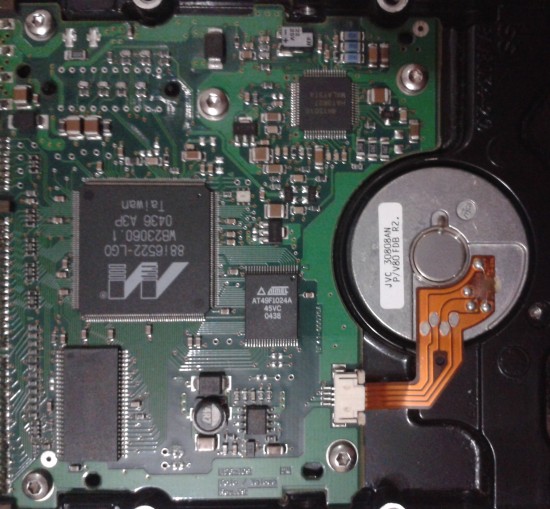

I have a Samsung SP1203N IDE hard drive that won't spin up. What I tried so far is the freezer method where I left the drive there for four or five days to no avail; and putting a multimeter on diode mode and testing what I think are TVS diodes on the PCB (model BF41-00076A, the same board as this one) to get the following results:
(Hard to read) AE O436, right beside the 4-pin power connector reads .457 in one direction and 1. (no zero next to that) in the other.
428 LEM, center right one in the picture reads .544 and "1."
(Also hard to read) 420 1BL3, center left one reads .109 and "1."
Does this mean that these diodes, if they are in fact diodes, are not the problem? If so, what could the problem be?

The diodes are OK. Could we see a detailed photo of the PCB?
Re: Samsung IDE hard drive won't spin up
December 12th, 2013, 15:17
Sure, here.
December 12th, 2013, 16:14
I would measure the voltages at the points identified in the attached photo clips. Be very careful not to short adjacent pins with your probes, as catastrophic damage will result.

And I just measured the spots you pointed out in the pictures in the 20VDC range:
    First picture, from top to bottom: 0.00, 2.05, 2.05, 2.05
    Second picture:
      Top one, from left: 4.03, 5.06, 3.32
      Bottom one, from top: 2.04, 2.05, 1.34

I confess that I don't know what the onboard voltages should be, but your measurements don't look implausible to me. That said, I think a PCB swap would be more expedient than trying to repair it.
As for condensation, there have many discussions on this subject, and AFAICS the real facts are that condensation only occurs when a surface and the surrounding air are at different temperatures. AISI, as long as you don't snap freeze your HDD, or stick it in the oven after removing it from the fridge, then condensation shouldn't be an issue. In fact regular HDDs are specified to withstand non-operating temperatures as low as -40C. Moreover, Seagate and Hitachi both have drives (eg Endurastar) which are specified to operate at -30C. These are used in automotive applications and the like.
December 15th, 2013, 16:53
Maybe the problem is elsewhere : if you don't have a spare pcb close to the original as possible, you cannot try.
Measuring and speculating won't revive the board, especially if the rom, mcu or CIC are dead (discover that yes, the Ram is powered but everything else is flatlined is not exactly useful).
Why waste time (assuming the thread is real and nothing is missing...) ?
