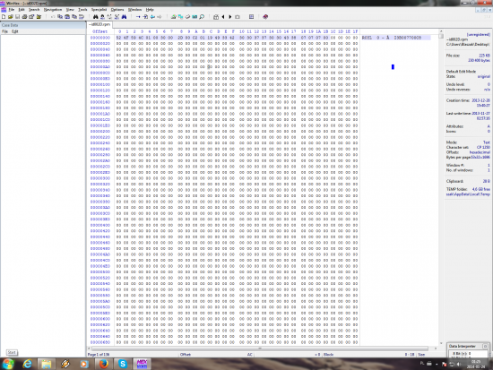

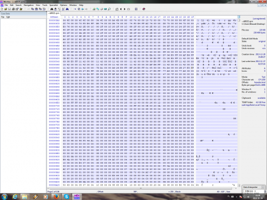

ok, i was opened modules 2D and 2E in hex editor
and what's next ?
Re: Need ROM of WDC WD10EADS-22P8B0 ._01.00A01
January 23rd, 2014, 20:20
mmm... :roll:
looking mask ROYL.
January 23rd, 2014, 20:27
ok, so
result is in attachment:

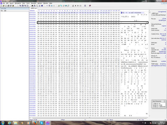

yes it's true, because I'm a sissy in these blocks we simply ask for help. attachment result:
My english is based mainly on the google translator, because I come from Poland and thin with me English. So something is not clear then please write. Regards! I thank you in advance that a colleague wants to help me.
January 23rd, 2014, 22:12
2Eh long module. 016Dh=365dec blocks. Why do you show me his start?
p.s.00A0h =/= 000Ah.

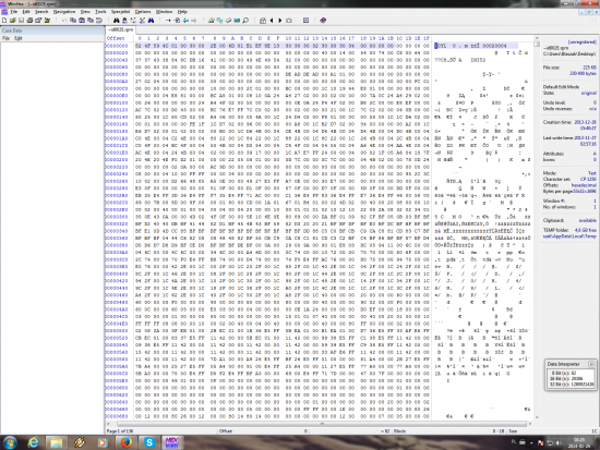

That it will be!?
I think it would be better to verify the fellow himself, because when it comes to a hex editor, it's hard for me with it. btw, 2E module is included as well ....
January 23rd, 2014, 23:22
offs.05978h: 020B
offs.1CC9E: 004F
and etc.
