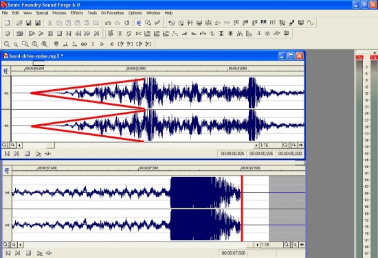

Recorded sound is incomplete!
At the beginning of the sound fade in is noticeable and the end is simply cuted off, so these are the reasons why is not possible to hear spin up and spin down - they are not in sound file!
Re: Noise From Hard Drive - Won't Read (noise mp3)
March 16th, 2014, 5:59
Can you upload the full sound of the drive from the moment you flip the switch to the moment you turn it off.
