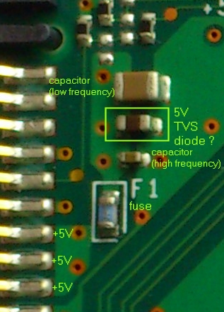

As for the fuse, I wouldn't bridge it. There is most certainly a fault elsewhere on the board. If you would like to do some simple testing, then upload a detailed photo of the PCB.

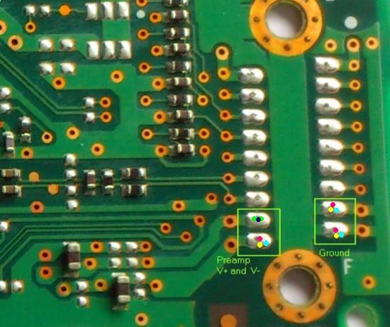

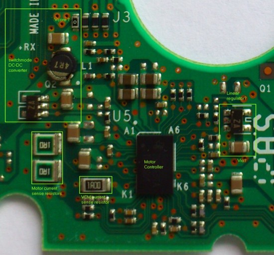

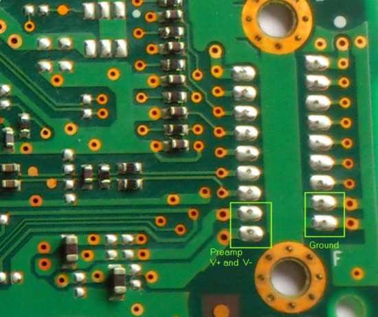

There are some measurements that you could take to assess the extent of the damage. The first would be to measure the resistance of the fuse and a component which looks like it might be a 5V TVS diode. If the diode measures close to 0 ohms, then remove it and retest both the diode and the circuit. If the circuit still measures 0 ohms, then there will be problems elsewhere.
The protection devices on Hitachi HDDs don't appear to do a very good job, so even after removing a shorted TVS diode, there may be additional faults. The next thing I would do would be to determine whether there is any continuity between the +5V pins at the SATA power connector and the V+ / V- pins at the preamp connector. If so, and if the fuse F1 is open circuit, then this would mean that the supply to the preamp is not fused, which would in turn mean that the preamp may be damaged. What resistances do you measure between +5V and V+ and V-?
The next thing I would do would be to measure the resistances between ground and each of the Vcore and Vio test points.

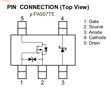

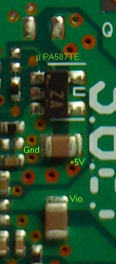

I think the Vio regulator is probably wired as follows:
uPA507TE, NEC, P-Channel MOSFET with Schottky Barrier Diode, marking ZA, 20V. 2A:
http://documentation.renesas.com/doc/Do ... V0DS00.pdf
http://pdf.datasheetcatalog.com/datashe ... oac03y.pdf
Edit: The Vio supply is wired to the SDRAM's supply pin, so it would be +3.3V.
K4S641632K, Samsung, 64Mbit, 1M x 16Bit x 4Banks SDRAM, 3.3V:
http://www.datasheet.directory/samsung/ ... K-UC60.pdf

Have located a DMM and have a few measurements for you but need a little clarification on where to take readings from Vcore and Vio components.
I'm new to this and its been a steep learning curve to say the least this past week but I'm in it till the end now.
At this stage I'm trying to preserve donor HD until I know without shadow of a doubt patient PCB is shot and irreparable. Of course I will take your advice and swap over NVRAM chip at U6 if original pcb is not salvageable to donor I have.
Here are some readings for you. (Meter set at 200K)
F1=0.01 ohms
5TVS Diode = 0.0 ohms
Resistances between +5V and V+ and V- = 3 read 0.1 ohms and 1 read OL Please see attachment.
There was no continuity from sata 5v to any of these points so am hoping pre amp is unaffected.
A long shot but could it be just F1 is faulty?
Look forward to hearing from you soon.
