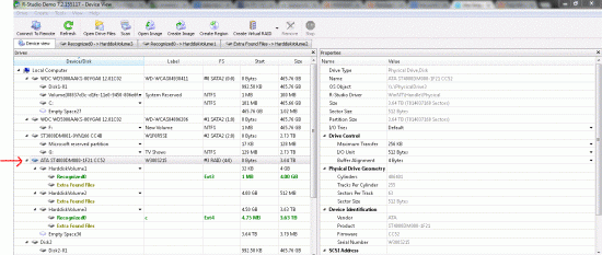

Thanks for the tips so far. I downloaded R-Studio and did an initial scan on the drive. I've attached a screenshot of the initial results. You can see the 4TB drive that is listed and it shows 3 volumes and an empty space item. Volume 1 and 3 seem to show as ext filesystem, but the volume I'm looking to recover the partition I had when it was in my windows 7 system. I'm 99% certain it was formatted as NTFS. I'm not an expert in this space so any additional tips/thoughts on next steps would be great. I think like 70% of the data on the drive was backed up, so my first goal is to simply get a list of what was on it. From there I can decide how much additional effort I should put into further recovery.
Thanks!

Cpmiller22 wrote:Thanks for the tips so far. I downloaded R-Studio and did an initial scan on the drive. I've attached a screenshot of the initial results.
I'm not sure this is a screenshot of R-Studio. At least, I've never seen such its panels.

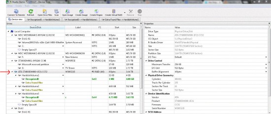

Many appologies on posting the wrong screenshot! here ks the correct r-studio screenshot:
I'm sorry, I somehow managed to post the wrong screenshot! :oops:
Here is the screenshot from R-Studio:
Re: Recover from formatted disk?
June 25th, 2014, 7:52
Based on the formatting circumstances, it looks as expected.
Pretty confident you will not be able to see the original file structure as the "metadata" responsible for doing so likely has been overwritten.
If lucky, can get some data only in RAW format. Loose files sorted by type.
June 25th, 2014, 10:39
I'd still look at the drive content to check that the drive hasn't been 0-ed. Right-click the drive in R-Studio and select View/Edit.
Usually some NTFS remnants remain even after a disk format, and there's none on the screenshot.
June 30th, 2014, 14:57
Thanks for all the advice. I couldn't find any ntfs bits anywhere, so it looks like I'm out of luck. Luckily for me I think I have almost all of the data backed up elsewhere.
