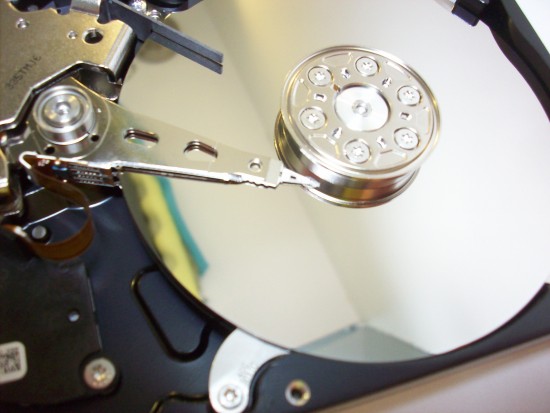

An ST3500320AS (SD35) is clicking for some time, then stops spinning after having parked the heads arm in the middle of the plater, leading to a nice sticktion, every time.
I haven't seen such a case before. First thought was corrupt ROM. Does anyone more experienced have any idea what could be the cause of such behavior?

I did try another PCB, with original ROM (it is the original ROM, checked S/N), same behavior.
The head arm sweeps over all the platter when clicking, and parks in the middle. Doesn't move to the parking zone when motor spins down.
It does the same think every time.

Isolating the HDA conector leaves the headstack unmoved on parking zone. Seems the auto-return mechanism in power-down is for some reason missing. Cannot think if there is something mechanical to check.

Hi kaxi, can you send us pics from Platters and Headstack. maybe usefull
The HDD is internal drive or external Drive?
what are simptoms to Fail?
i think in this case in important to know how the HDD was used.
bye

Then you have always the same problem. I wonder if there is servo calibration or not at start and I would like to see a pic of heads under microscope...
Re: Suicidal ST
July 11th, 2014, 3:22
I'm afraid this is the best I can do for now.
The drive was an internal one, and it has been opened before elsewhere. This is all that I know for the drive's history.
The headstack clicks swapping the whole platter radius, and pausing momentarily for 2-3 times at positions about the middle, until "parking" at the middle before spin-down.
Re: Suicidal ST
July 11th, 2014, 8:14
I think this HDD will not be recoverable, if HDD was opened in other sites, is very difficult to work, you do not know opening conditions, and what testing, pieces exchange, ... they do it, hard to work in this condition.
But i think you have heads problems or maybe media damage.
As BlackST says, a pic from heads under microscope will be good.
