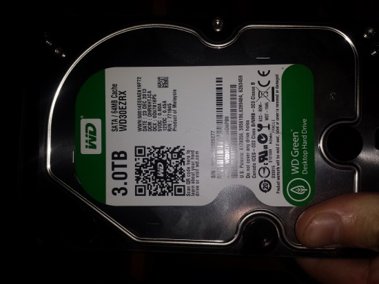

Hello all, I am new at this, i have been scowling the forums and the net for weeks and haven't found anything or anyone that can help with my problem.
The problem is this. i recovered a partition to get my files off after i accidentally did something to the drive.(cant remember what), this worked great i could access everything. and the drive ran great. i rebooted a day later to start getting the files off and the hard drive was so slow i couldn't even watch a movie but my data is there. after many attempt at recovery the drive now hangs my system on start up for hours on end. there is no clicking or grinding. i bought a donor drive for the controller board i got as close as i could find to the same model, but i cant initialize the disk after swapping control boards over, how can i make this work? please i am new and dont have much experience in this particular field so please be patient and explain as i want to understand what your going to say.
Thank you.
Old drive:
WD30EZRX
S/N:WMC1T1793240
MDL:00DC0B0
New Drive (BOARD DONOR):
WD30EZRX
S/N: WMC4N1605277
MDL: 00D8PB0
windows 7 x64
New donor drive
old drive i need the data off

@Gh0s7, it doesn't sound like a PCB fault.
However, if you insist on swapping the PCB, then be aware that each PCB has unique, drive specific, "adaptive" data in flash memory (aka "ROM"). These data must be transferred from patient to donor. Some PCB suppliers include this as a free service. If there is an 8-pin chip at location U12, then the transfer is relatively easy.
BTW, the R/N numbers on the drive labels would suggest that the PCBs are different, ie 2060-771824 versus 2060-771945. It may be that they are compatible, though. In fact the Marvell MCU part numbers are different, FWIW.

"fzabkar" is right, it's not a PCB fault.
You shouldn't swap PCB because problem is not on PCB.
The problem is more serious (inside the drive), if you are lucky maybe there is just an issue on Re-Lo list module on SA firmware, if you are not lucky then can be bad sectors or even weak heads.
However it's not a DIY job!
Send the drive to a pro before is too late, price to recover data would get higher if you mess with it (or worse, no data recovery at all).

July 18th, 2014, 14:42
Gh0s7,
You have an incompatible donor from another family
Diablo3D vs Diablo3S
99,99% control boards not guilty.
