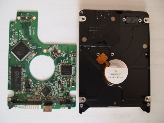

I've got a 500 GB Western Digital WD5000BMVV-11GNWSO. That's one of those disks with only USB on the PCB.
After connecting it to the USB, the disk doesn't make any alarming sounds - it rotates the platters, blinks the LED. Unfortunately, it's not recognized by BIOS.
My drive is: WD5000BMVV-11GNWSO
My PCB is: 2061-701675-604 04P
I found a donor who might send me these:
drive 1: WD50000BMVV-11A1CSO
PCB 1: 2061-701675-002 04P
drive 2: WD5000BMVV-11GNWSO
PCB 2: 2061-701675-604 10P
My question is if I have any chances to use his PCB to rescue the data from my drive. If you think yes, what exactly would I need to do? I read that I surely would need to replace the 8-pin chip. Anything else?
My other question is about the method to solder some wires and removing 4 capacitors to get the access straight to SATA. Is it really doable? I read that I might get encrypted data out of that. Do you have any experience with that?
Best wishes,
Piotr
PS. I attach the photos of the disk in case it might be useful:

@kelnerrr, these PCBs often have connection problems at the USB connector. Depending on your level of skill, there are DIY methods to narrow down the source of the problem.
I would remove the PCB and invalidate the bridge firmware to see whether the bridge IC identifies itself in Device Manager. This will at least confirm whether the bridge is working. Could you upload a detailed photo or scan of the component side?

Re: WD5000BMVV - disk not recognized by BIOS
October 9th, 2014, 7:22
Dear all,
finally I got my screw set and was able to detach the PCB. Here comes the photo of the other side of it (dark side? ; )
Thank you for your ideas,
Piotr
October 11th, 2014, 1:39
Pin #7 of U14 (/Hold) appears to be hardwired to Vcc. This means we can't short it to ground as I would have liked to. Doing so would have invalidated the firmware, in which case the bridge IC would then have identified itself as an Initio Default Controller.
If you connect the PCB on its own to a USB port, does it appear in Device Manager?
Does UVCView detect it?
http://www.users.on.net/~fzabkar/USB_ID ... ew.x86.exe
October 15th, 2014, 15:36
UVCView is indicating that something is present on the USB port but it cannot communicate with it. You could try shorting the data output pin of U14 to ground while powering up the PCB (Ace Lab uses this approach, but it makes me feel uncomfortable). If the bridge then identifies itself as an Initio Default Controller, my approach would be to convert the PCB to SATA mode and then try to retrieve the drive's firmware resources. The next step would depend on what we find.
