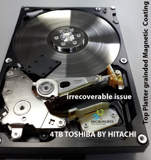

One of Our Data irrecoverable Case Dairy-Toshiba 4 TB as per user statement suddenly get Problem as not detecting.

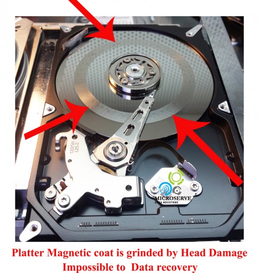

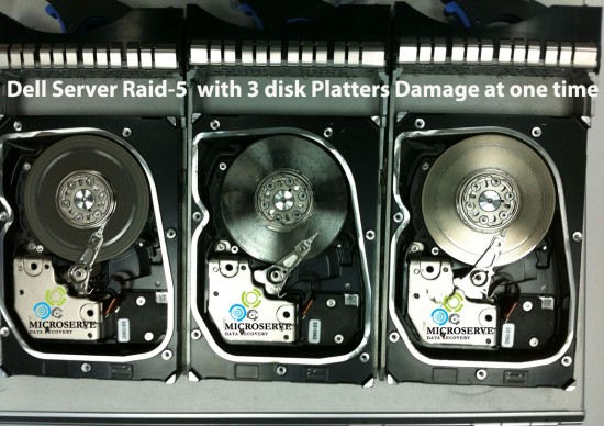

One of Dell Server 3 Disk Platter damage at one time.
Re: IRRECOVERABLE ISSUES BY PLATTER DAMAGES
October 13th, 2014, 4:46
Good example of irrecoverable case.
Sometimes is difficult for customers understand why data is not recoverable, but in this case normally they understand it

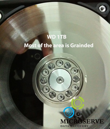

WD 1 TB

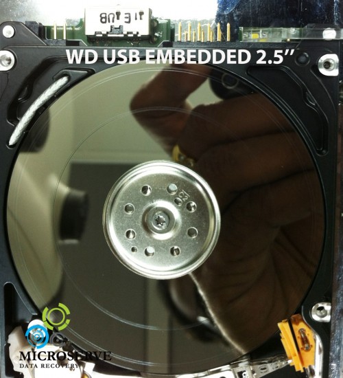

WD 2.5'' USB EMBEDDED HDD Slight scratch But irrecoverable

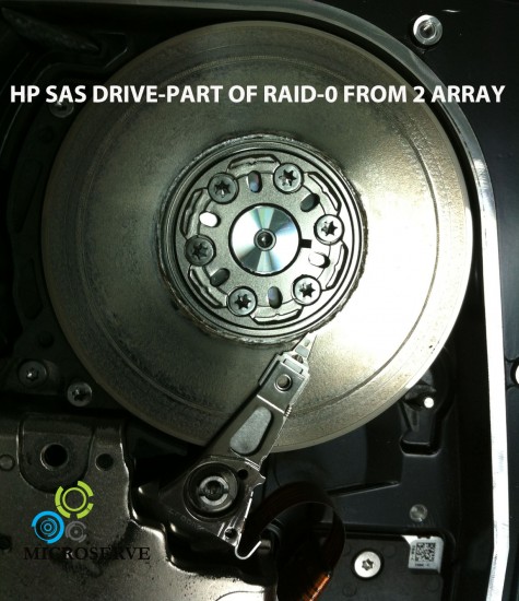

SAS RAID-0 ARRAY MEMBER

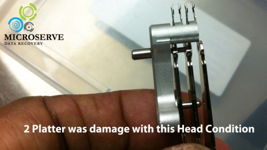

October 13th, 2014, 5:27
How Head comes like this..but 2 platter was damage with this head

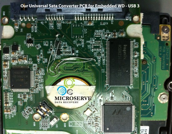

October 13th, 2014, 5:44

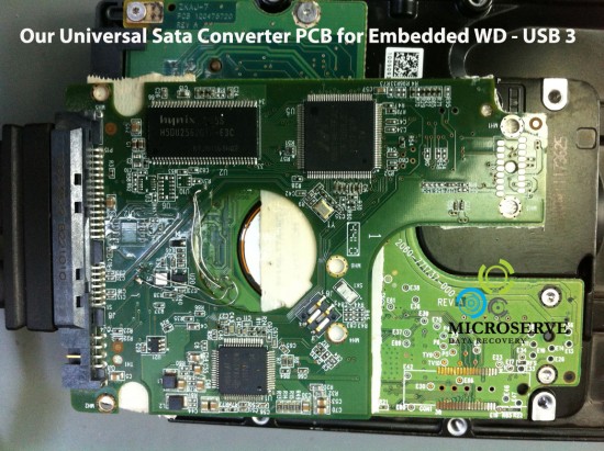

Our Universal Sata Converter for WD Embedded USB-3

safwan1967 wrote:WD 2.5'' USB EMBEDDED HDD Slight scratch But irrecoverable
IF it is only this surface, this can be recovered partially with no guarantee (if and only if it is a vital case....) but requires a lot of intervention - let alone encryption. The other are not.

Toshiba New Case IRRECOVERABLE ISSUES BY PLATTER DAMAGES
