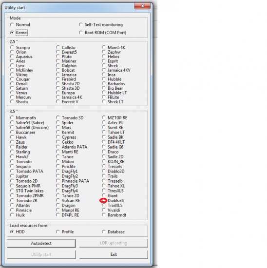

those 3 drives are brand new. i am trying to test it with PC3K but not recognized falimy drive.
on Mod C5 says DIABLO3S FAMILY BUT pC3k NOT RECOGNIZE IT.
witch ones must i select on PC3K? diablo3d? or others?

Yep, it's Diablo3S

But in my PC3K do not apears Diablo3S family, the most similar family is Diablo3D
is need select on PC3K Diablo3d?

latest version do have support for Diablo3S.
