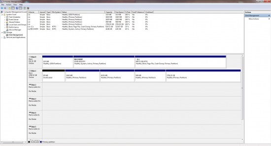

I cant mount/retrieve the data inside the hdd. This hdd previously is used on a NAS storage. Any clue on how to retrieve the file?
Refer the image below, my computer can detect the drive. However, there is no 'file system' being detected by windows. The window using are window 7 Ultimate.

Maybe the data are encrypted.

Must guess as you didn't mention NAS maker: Most NAS are in EXT2 file format. To mount that type file system to windows use a product such as ext2fsd to begin.

It is very rare that I see each drive setup as their own JBOD...usually, at the very least, the main partition on each drive is merged together as a single JBOD. If the data is important to you, you may not want to risk playing with the drive too much and seek the assistance of your local data recovery professional while the cost to recover the data should be at the lower end of the pricing scale.

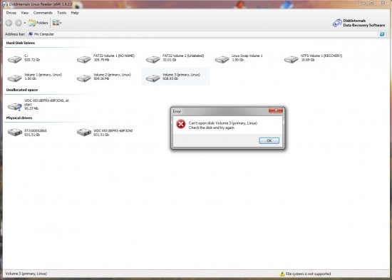

Try Linux Reader for Windows (freeware):
http://www.diskinternals.com/linux-reader

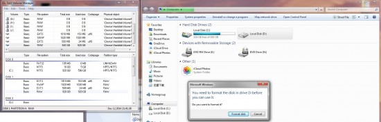

warnerr wrote:Must guess as you didn't mention NAS maker: Most NAS are in EXT2 file format. To mount that type file system to windows use a product such as ext2fsd to begin.
The maker of my NAS is seagate. The model is BlackArmor 400. I tried to mound using ext2fsd, but i cant access to the HDD. Check the picture below. I still cannot access to the drive.

Try UFSExplorer...if you can't see the file system with it, you will definitely need professional data recovery assistance.

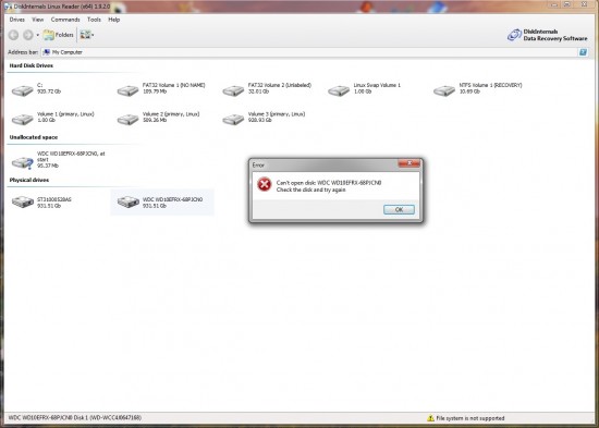

fzabkar wrote:Try Linux Reader for Windows (freeware):
I got the error message as attached.

Can you read the other drive?
What was the capacity of the NAS?

The reason I asked whether you could read the other drive was to determine whether the subject drive has a damaged file system, and whether the two drives have separate file systems.
