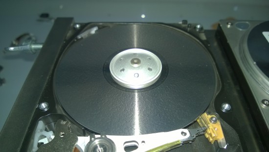

Is there a chance/solution/technique to recover data from a such disk (HDS725025GLA380) :
[img]
[/img]
Re: platters looks weird
February 3rd, 2015, 11:10

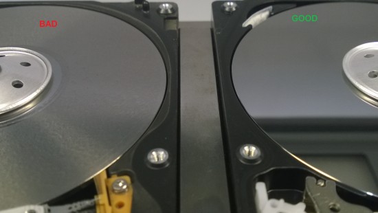

What you see is massive media damage
All data is in the filter now
Cannot be recovered

Thank you for your reply.
Could anyone tell me what could cause this damage please?
February 3rd, 2015, 13:28
sosrecup wrote:Could anyone tell me what could cause this damage please?
HSA sliders filed down the surfaces
February 3rd, 2015, 13:35
I would guess the top slider came off and the arm was just scratching the surface for some time.

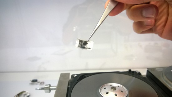

Sorry for offtop but I have question about the "dust" on the filter. What is it this "dust", it is the rest of the magnetic layer that platters are covered?
February 4th, 2015, 9:43
samurai7 wrote:Sorry for offtop but I have question about the "dust" on the filter. What is it this "dust", it is the rest of the magnetic layer that platters are covered?
Yes, it is platters' top layers shredded to dust.
That dust is in the filter, as well as it's the origin of the "ornament" on the surfaces
February 4th, 2015, 16:22
The surface texturing you see is part of the raw/crude first stages of polishing the platters.
