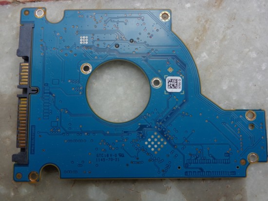

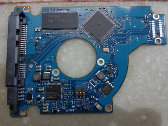

Hello everyone,
my Momentus drive connect in F3 mode
this err showing is :
EarlySpinup Enabled
Rst 0x10M
Execute
SpinRequest
LED:00000067 FAddr:00380338
any PCB short need this one.

Re: LED:00000067 FAddr:00380338 Erron Momentus Drive
February 11th, 2015, 9:37
Try transferring the ROM to a healthy donor PCB and report back your findings.
February 11th, 2015, 11:10
lcoughey wrote:Try transferring the ROM to a healthy donor PCB and report back your findings.
+1
