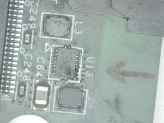

Anyone ID this chip?
April 7th, 2015, 14:43
This is from SSD burned chip
thank you
Re: Anyone ID this chip?
April 7th, 2015, 15:13
Judging by the coils and chip location it's two-channel power management IC, most likely for the CPU and NAND chips
Maybe something similar to this - http://www.ti.com/lit/ds/symlink/lm10502.pdf
