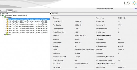

I'm planning on using the drives for general server storage purposes, behind an LSI MegRAID 9261-8i card in a small internal SAS enclosure. This card and enclosure support 8 disks, so that's all I need to flash, but I have many others.

I know, right? You would think it would be a supported configuration, but apparently not:
LSI Screen Shot

We found a solution, using sg3_utils to do a low level format has made the drives usable in whatever systema nd config we want.

Just an update - I was able to get the HGST drives working with the NetApp firmware NA00, but I needed an update from Avago for the 9261-8i firmware. Those files don't seem to be available anymore, but I have a copy if anyone needs it. These RAID cards are getting older and I don't think they'll be viable much longer.
